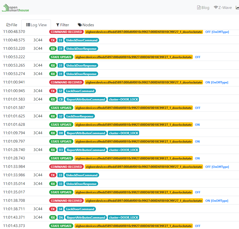

smitopher@myth-server:~$ openhab-cli info
Version: 3.2.0-SNAPSHOT (#2614)
ohhhh… much better
Not the most consistently speedy responder or reporter
It can vary from right away to 3 seconds
ohhhh… much better
It’s a battery device, so it will take time as battery devices are only polled typically every second in Zigbee (or more specifically 802.15.4).
Anyway, I’m pleased this is fixed ![]()
