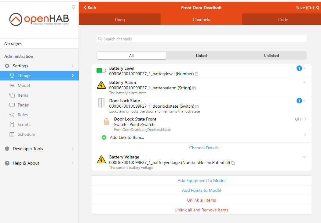

I have setup 2 Yale Assue SL locks with the Zigbee module
Adding them to OH was straightforward
The lock responds very slowly, when it does
OH does not update when the lock is manually operated

The lock xml
000D6F0010C99F27.xml (106.1 KB)

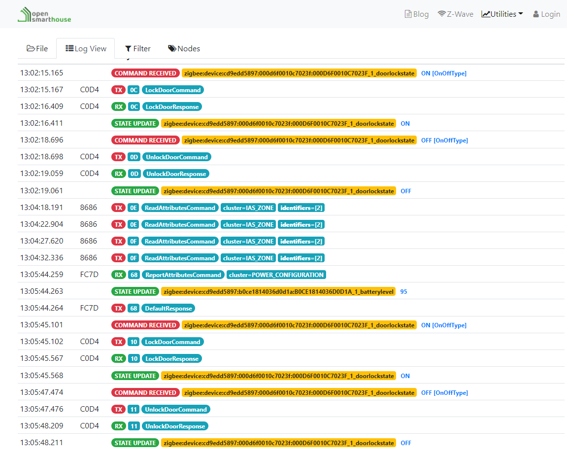

Yes, use the log file viewer -:
Looking at this I can see some delivery failures from the dongle which likely indicates there is a poor connection to the device -:
This shows the first command sent to the device fails - the coordinator was unable to deliver it. The binding then retries this, and it is successful, but we then also receive a number of responses. Again this indicates that there is likely a communications issue between the coordinator and the device.

@chris I’m following up
I have a much smaller OH log
Same test
Set Zigbee looging to DEBUG
Lock and unlock Zigbee Yale Assure SL from OH
Lock and unlock manually
Lock and unlock using Yale Assure SL Keypad
Set Zigbee logging to INFO
openhab.log (125.2 KB)
Log viewer
I see my OH commands and state updates, I don’t see much that I understand in-between the OH lock/unlock iteration. Definitely no state updates for operations performed on the lock itself.
Do we need to get lower level trace?
