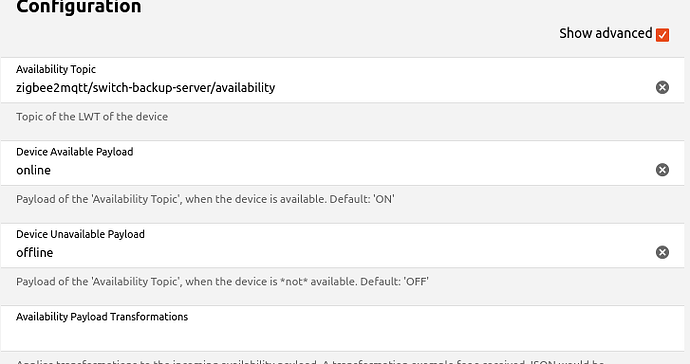

The availability feature checks whether your devices are online. The availability state of a device is published to zigbee2mqtt/[FRIENDLY_NAME]/availability (this message is a retained MQTT message).

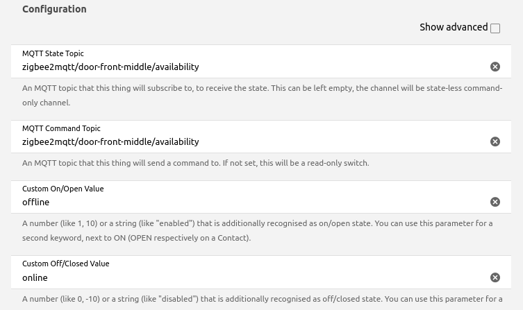

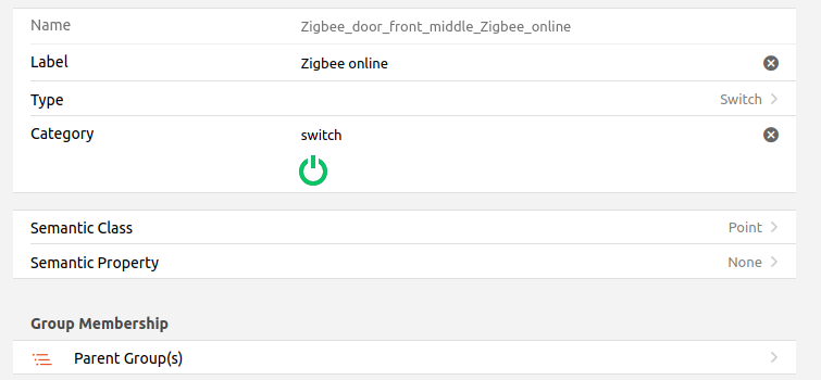

I managed to get a working status for all my MQTT.things.
But now i would like to get a switch-item to show me the current state. I tried following without success:
