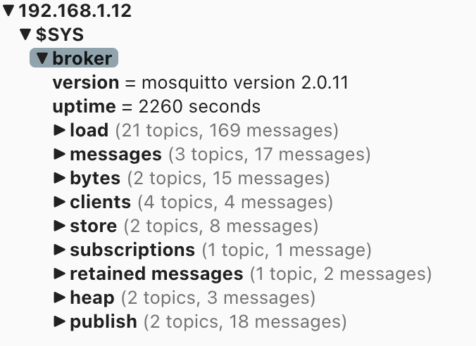

Mosquitto is reachable through MQTT Explorer:
AND this is the errors in log:

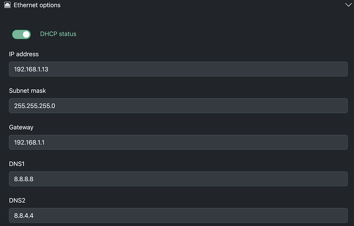

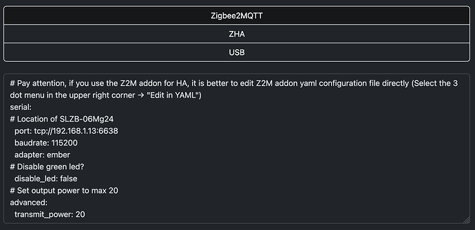

I have access to the zigbee adapter through its web interface.

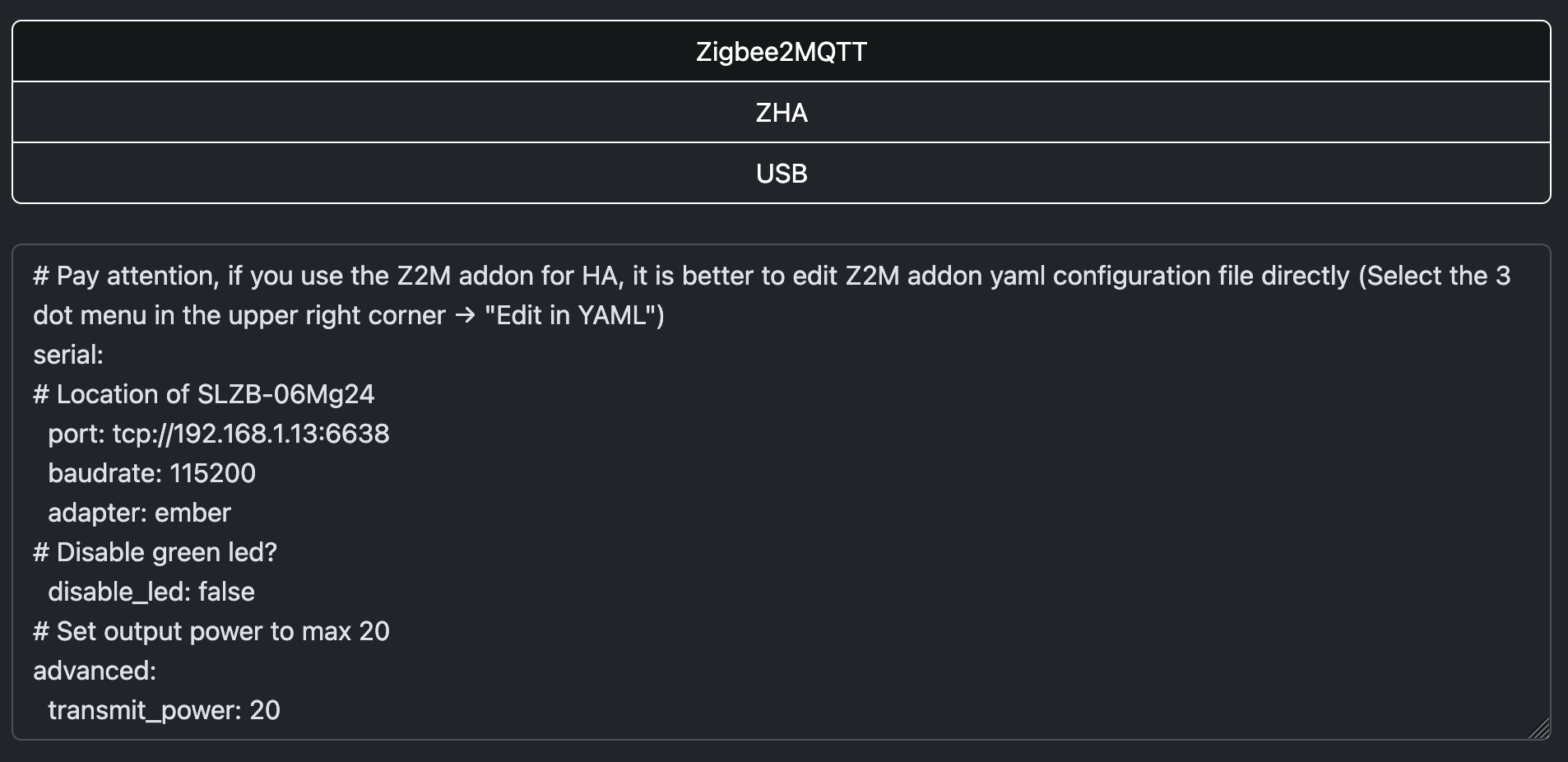

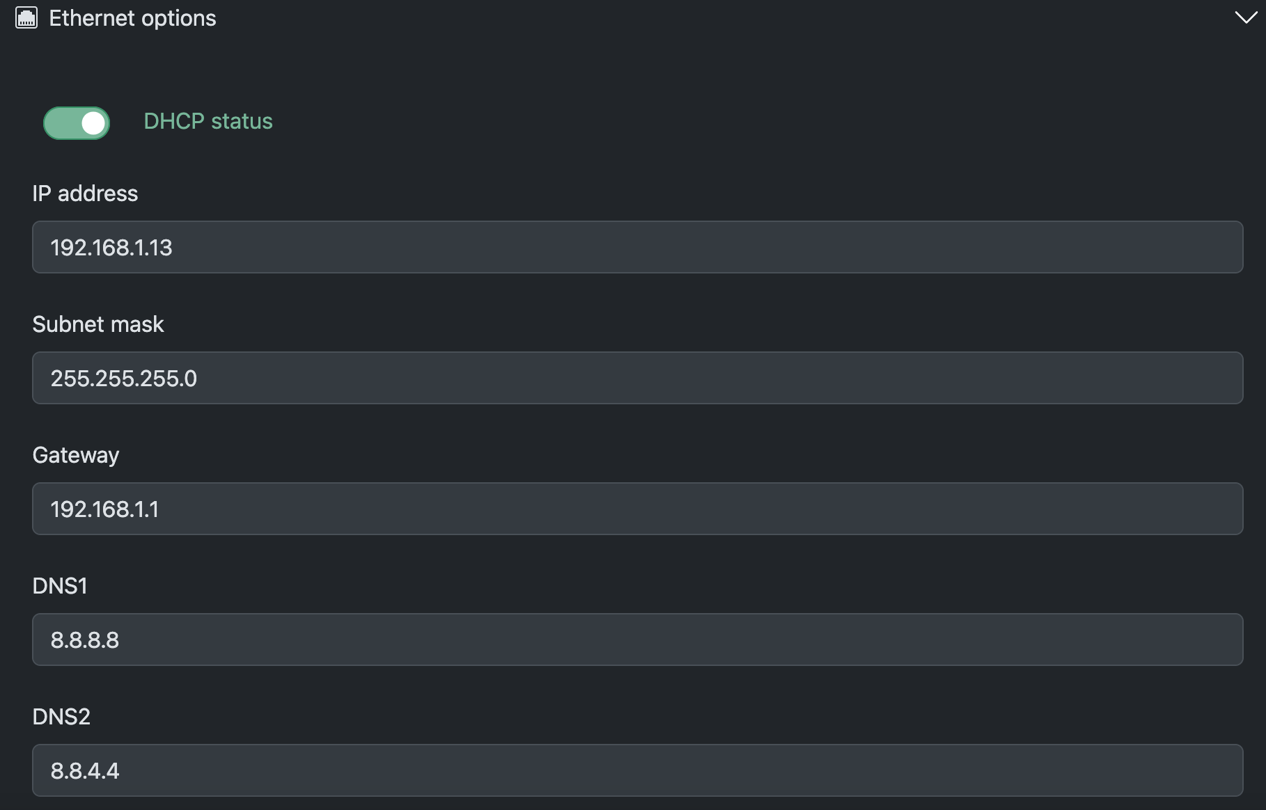

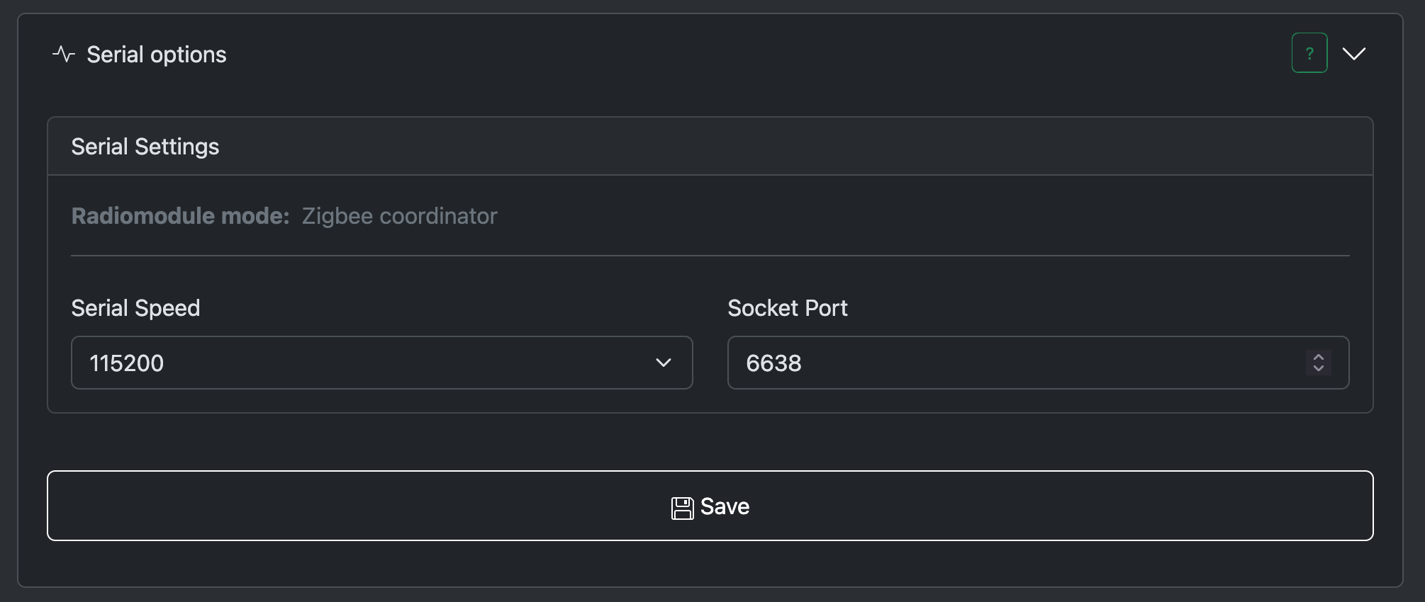

Here some prints screen:
Zigbee2MQTT settings:
Network Settings::
i think configuration. yaml should be
serial:
  port: tcp://192.168.1.13:6638
  adapter: ezsp
  baudrate: 115200
I set “ezsp” as value for adapter, but I got an error (see logs below). I think “ember” was the correct: it is the value proposed by the zigbee adapter (see above).

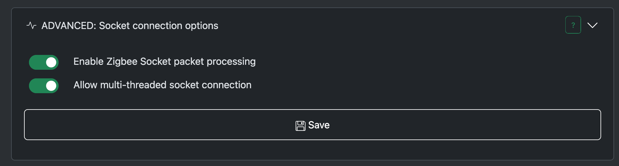

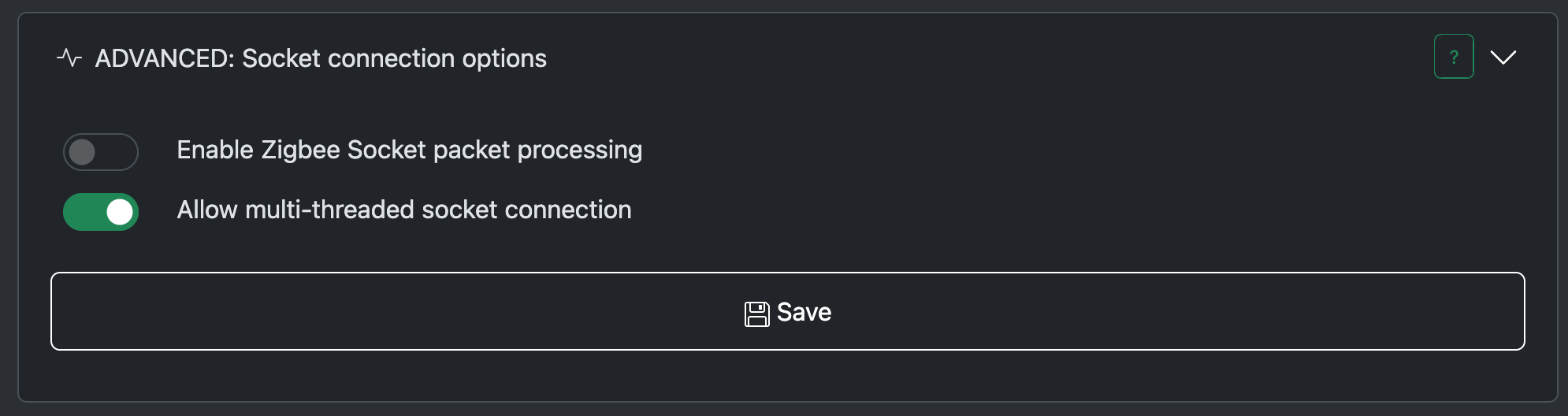

In the meantime I’ve contacted the support of the Zigbee adapter who was really responsive.
Disabling the “Enable Zigbee Socket packet processing” solved my issue.
Thanks to all of you that proposed their help.
…and thanks for posting the solution so that others might benefit from that.
