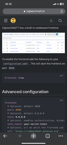

Not very clear what you did to provide sensible advise but, did you add this in your config.yaml file?
frontend: true
More info here: Frontend | Zigbee2MQTT
Check the ports too. Presumably openhabian does this automatically, but you’ll have to change the zigbee2mqtt front-end port, as the 8080 will clash with openhabian’s.
