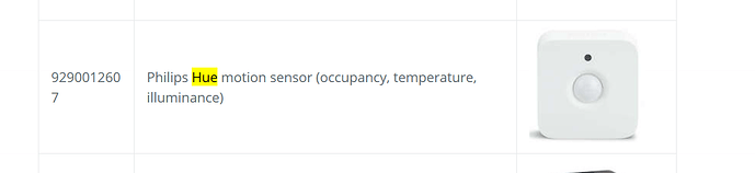

Post your item file and the Hue mqtt output, maybe someone can help. BTW I didn’t see the Hue Motion Detector listed in zigbee2mqtt supported devices. Did you use the “How to support new devices” guide to pair it with OH?
