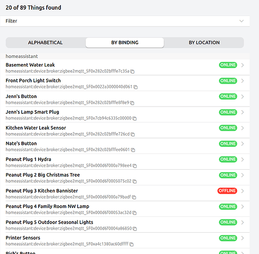

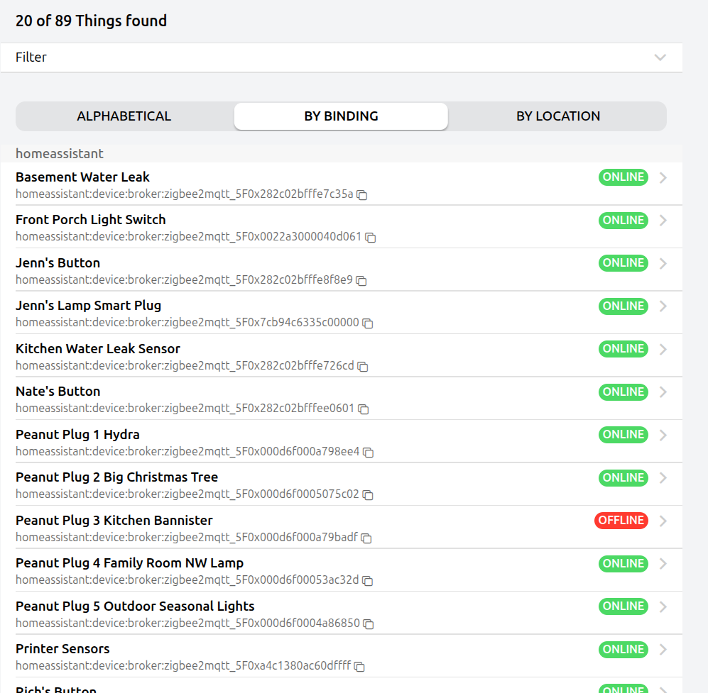

And here is an examople of a Zigbee2MQTT discovered Thing with an Event Channnel (i.e. stateless trigger):person_shrugging:

Look for the “componet: event”. An event trigger is a stateless trigger. You cannot link this Channel to an Item (without a profile). You use this Channnel to directly trigger a Rule.

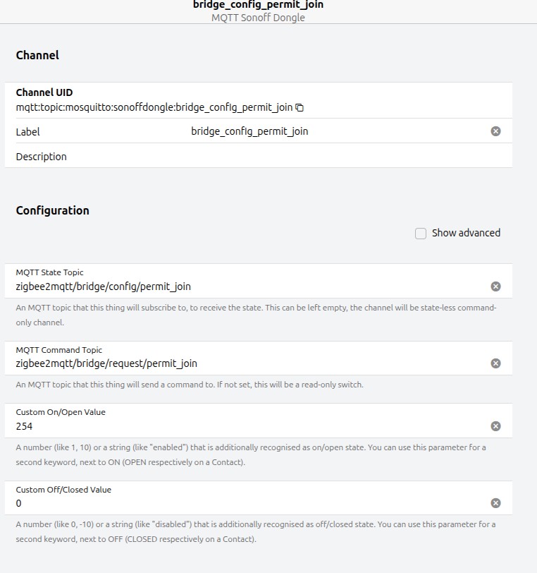

I set mine up a long time ago and used the json format and never looked at it again. It was before the simplified syntax was available. I just tried it now and indeed it can accept either syntax! TIL! :slight_smile:
Or you could send that mqtt message directly from a script.
Either way works. It’s just plain mqtt.
Example Ruby script:
z2m_permit_join = "zigbee2mqtt/bridge/request/permit_join"
things["mqtt:broker:mybroker"].publish_mqtt(z2m_permit_join, "254") # 254 is the max allowed, and must be a string
# Or use the alternative syntax:
mqtt_broker_mybroker.publish_mqtt(z2m_permit_join, "254")
Not outside your LAN you can’t.
Zigbee2MQTT supports controlling things like pairing mode and such through MQTT messages. In fact, OH should have discovered a Zigbee2MQTT Bridge Thing among all other devices which has a Channel to enable pairing mode, among other Channels:

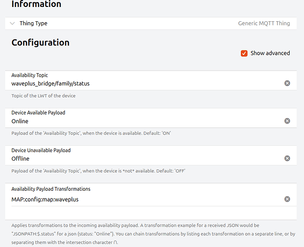

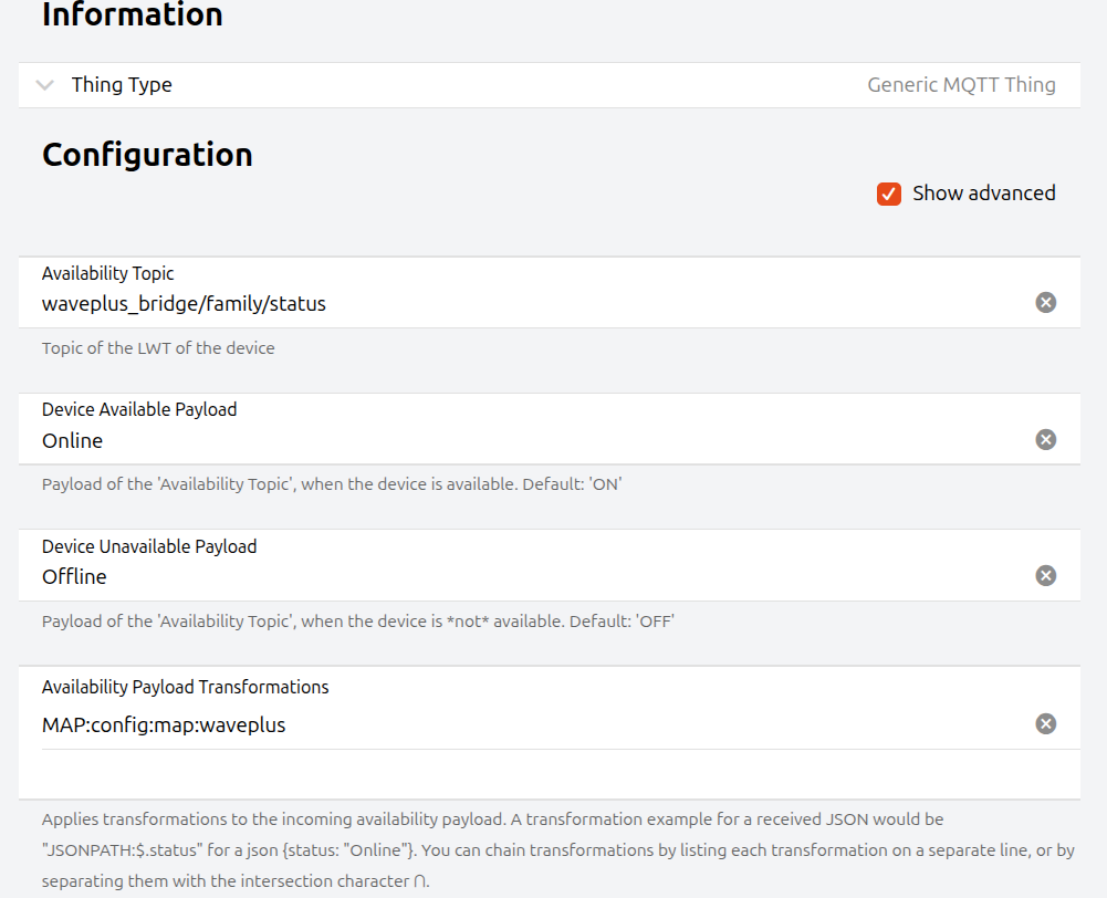

If using the HomeAssistant binding? Because the generic MQTT binding does not do that to my knowledge. And I did not enable HomeAssistant format for Z2M in the past because it had some issues (if I come across it again, I will get into more details what they were)
Thank you for the detailed explanation here, I already acknowledged that this is something a binding cannot do, but I will try your suggestions and report what I liked about them or what I did not elsewhere. Generally, the process to set up some button, for example in the WebUI, representing something that triggers e.g. an IR remote, seems way more tedious than for e.g. a switch. There are even UI plugins that implement this missing functionality, and the whole thing with rules that set an “on” state and then reset it immediately seems hacky. But again, not part of this topic.
I’m not arguing that everything is fine and no improvements need to be made. But several of the ideas are already implemented and several are not feasible in OH or with the technology.

The Home Assistant binding does discovery on startup, and I think it does discovery periodically. You should be able to kick off a scan through Settings → Things → + ->Home Assitant Binding → Scan. Though make sure to check that you haven’t previously ignored this Thing.
I didn’t do anything special to discover and add this Thing. It was just one among the many that came from Z2M.

The Generic MQTT binding can do that too if you set it up to do that. The online/offline status of individual devices are published to (assuming you left everything at the default (zigbee2mqtt/<device name>/availability) where you will find {"state":"online"} or `{“state”:“offline”}.
In the Generic MQTT Thing check “Show advanced” and you will see options to configure the Thing to set the Thing’s status according to the availability topic.
For Home Assistant it does it automatically.
However, it appears these messages are not retained so unless Z2M has published an updated messages recently you might not see the topics in MQTT Explorer. But the availability topic is part of the spec.
I think there is another topic that controls the ONLINE/OFFLINE availability of Home Assistant HA Things too but I’d ahve to do more research to be sure.
