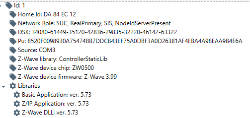

Here some detail information about the stick, captured with PC Controller:
That stick is AFAIK from zwave.me. I doubt you were ever able to run/backup that with the Silicon Labs software. Get the z-way software from the zwave.me website.
