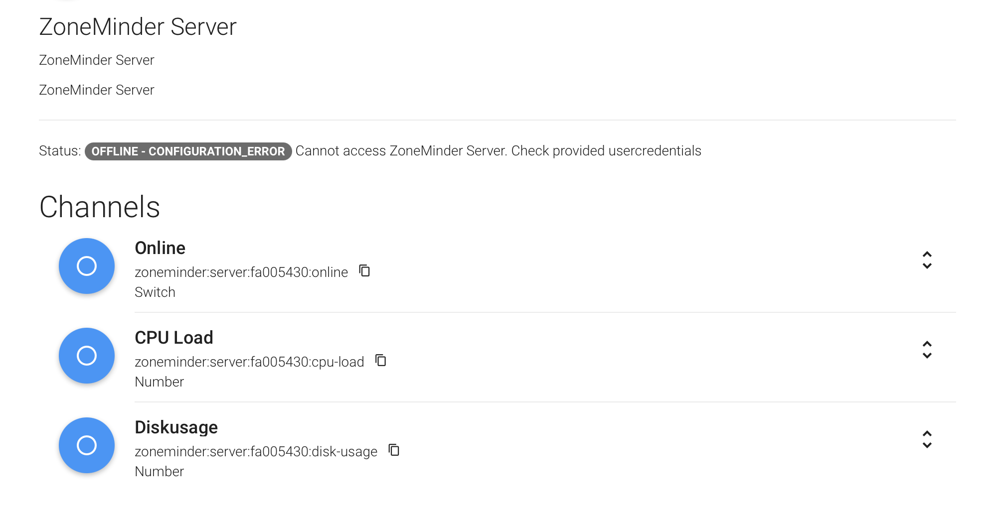

Hi - I am trying to connect from OH 2.5.12 to my ZoneMinder installation 1.34.26, both running on a Debian SOHO server. On ZM I added a specific user for the API, enabled the API for it and logged in to the ZM GUI w/o problems. OH2 however gives me the “Cannot access ZoneMinder Server. Check provided usercredentials” thing. I finally tried:
root@tiger:~# curl  -d "<username>=openhab&<password>=xxxxxxxx&action=login&view=console" -c cookies.txt http://192.168.31.5/zm/index.php
as suggested in the binding’s instructions. This however does not provide any screen output but only populates cookies.txt, independently from whether I insert the correct or an incorrect password. Probably I am missing something very obvious here.
Can somebody please point me in the right direction ? Thanks - Martin

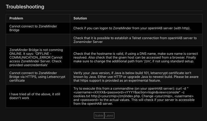

did you literally enter
especially <username> resp. <password> ?
The parts before the equal sign have to be field names that are used in a web form.
I doubt that the < resp. > are part of the field names.
I found that here:
Well, now that I read that again, it says to change <username> and <password> with the actual values. But that does not make sense to me. What to do with “XXXX” and “YYYY” then … ?
