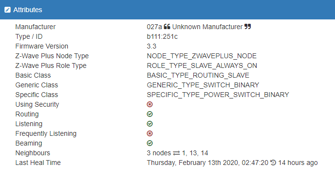

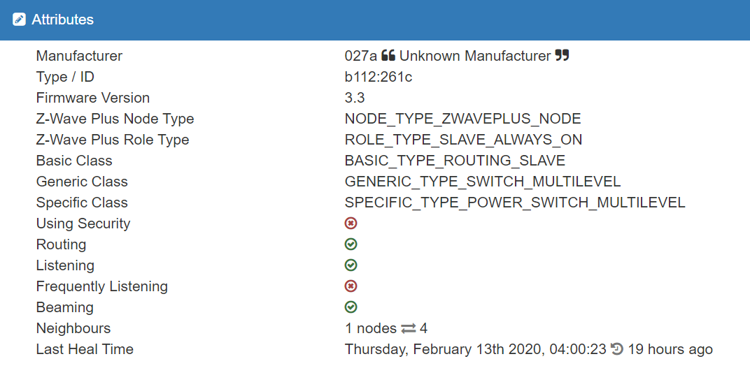

Please how us the Thing attributes from HABmin so we can verify that is the correct database entry for your particular device. It should look similar to this ZEN23 example.
Hey Bruce. Thanks for helping me out. Here are the attributes as requested.

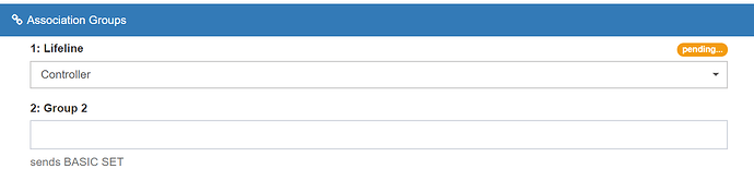

I also just noticed that in the associations it says “pending…”. Other Z-Wave switches don’t have this and are working just fine.
