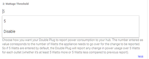

@chris I’m installing a Zooz ZEN25 double plug and PaperUI is only allowing me to select “5” or “Disable” for the Wattage Threshold. According to the Zooz documentation this should be user-defined (0 – 655350). Can I request this to be changed in the binding? I’m trying to measure standby power draw for my appliances, but below 5W it’s just reporting zero.

Same thing in Habmin: 5 or disable.
It’s the V2 revision of the Double Plug. I checked the database and both versions indicate that this parameter should be 0 to 65535.
There hasn’t been a lot of discussion about the ZEN25, so I’m guessing that it just got set up as a dropdown with these two options instead of a fill-in field. It’ll let me type in other numbers, but after saving the configuration it’ll return to 5.
I checked quickly . Are you sure you cannot fill in any value? The database entry looks like it should permit that.
Hah, I was just coming back to say that I was mistaken. I didn’t realize that it only records the parameter value if I type the number and then hit the Enter key on my keyboard (I was just typing the number and then clicking the “Save” button). Sigh.

If you look at the database entry you will notice a pencil icon in that parameter. That is what it means. I think we gave the 0 option to easily disable the feature.
Good to know. I haven’t had to look too closely at the database until now, so the pencil didn’t mean anything to me.
