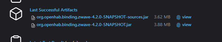

Trying to use the latest zwave binding:
Do I just substitute this .jar file for the org.openhab.binding.zwave-4.1.1.jar file already present?
Do I need to worry about the sha1 file?
I tried to find how to install this via the Add-on Store Bindings page but couldn’t find a way to access the snapshot.
If there’s a link that has the instructions, please let me know what it is. Are there instructions available for the other 2 options you mentioned?
In the solution post under ii) there is a link to bundle management in the documents. Basically in karaf use bundle:update.
Thanks for the hint. It’s working now.
