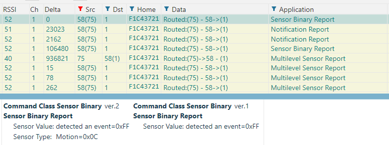

Probably not part of your normal problem-solving process, but I did trigger the device and captured via zniffer after seeing @JustinG post, just to see. I have had device working for about a year.
I highlighted the motion frame. What was somewhat strange is the notification was alarm tamper (3) not motion (8) (and I did not touch the device). 120 seconds later (per my parameter setting) the all-clear (line 4). The sensor reports (lines 5-8) are temperature and humidity.
Thanks. It would be good to see the logs as these are normally more useful for this sort of issue. While you have highlighted what you think is the motion frame, I can also see alarm reports here (aka the notification messages) so it may be that the device is sending multiple reports.
