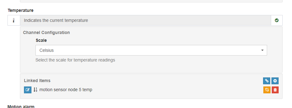

Any traction on this, I’m still seeing the values reporting in Celsius for my zse40?
Tried changing the setting from (C to F) in PaperUI and HABmin with no luck? I get an error 500 in PaperUI and HABmin shows no error but as soon as I go back and look at the variable its set back to Celsius?
This is quite an old thread, and a lot has changed since the previous posts. I’m not sure if that’s what you mean by “traction”?
I was just wondering if there is a solution to the following.
I’m not sure what you are changing? If it is the internal configuration parameter, then this has been removed and will not work on 2.4 or above. Maybe you refer to something else?
I was just looking for some help, and I was trying to change the tempature reporting from Celsius to Fahrenheit?
With either HABmin or Paper UI ???
Thanks for any help.
In the new binding, this selection has been removed as the system now uses the UoM features to automatically convert data into the units your system requires. I guess you’re using an older version - it might be worth changing to the latest snapshot or milestone release?
If you use the latest version, then the system uses the configuration you make in the locale section of the configuration.
Thanks for the update, I will look for the latest snapshot and try that…
Chris
Thanks for the help that did work!
:+1:
Chris

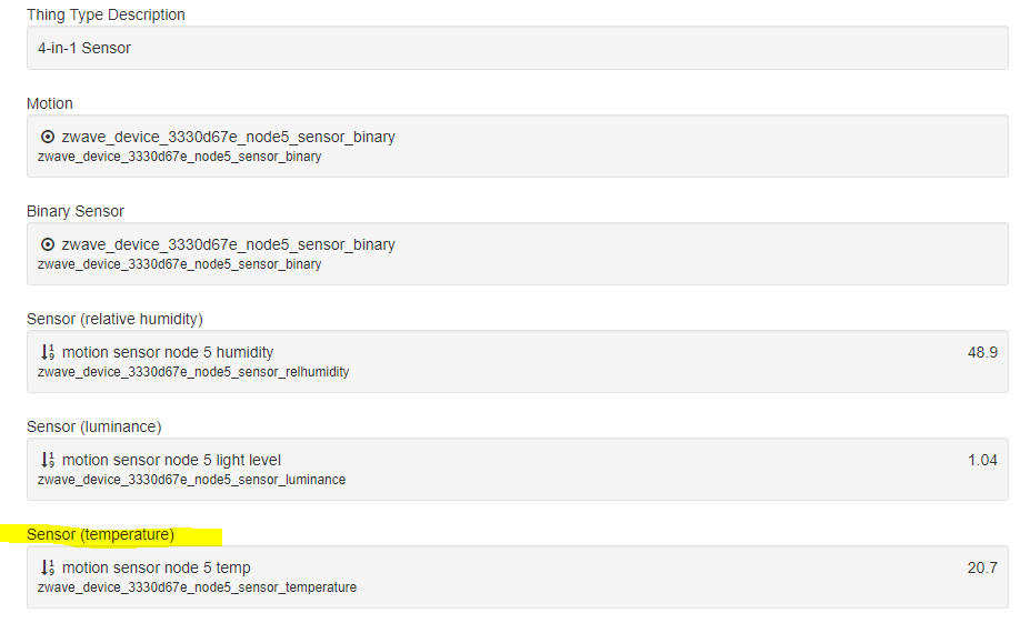

One other question, I do have two different ZSe40’s, one from (Vision Security and one from (zooz), I was trying to set up some rules over the weekend and I was not having much luck, I was wondering if you could confirm that my items file format looks right:
//node 4 is zooz and is the small one located in the Bedroom by (Vision Security)
Contact zwave_device_512_node4_sensor_binary “motion sensor node4 [MAP(zwave.map):%s]”
Contact zwave_device_512_node4_alarm_burglar
Number zwave_device_512_node4_sensor_luminance “motion sensor node 4 light level [%.1f]”
Number zwave_device_512_node4_sensor_relhumidity “motion sensor node 4 humidity [%.1f]”
Number zwave_device_512_node4_sensor_temperature “motion sensor node 4 temp [%.1f]”
Number zwave_device_512_node4_battery_level “motion sensor node 4 battery level [%.1f]”
//node 5 is zooz and has a bracket and is the one located in the Laundry room by (zooz)
Contact zwave_device_512_node5_alarm_motion “motion sensor node5 [MAP(zwave.map):%s]”
Contact zwave_device_512_node5_alarm_tamper
Number zwave_device_512_node5_sensor_relhumidity “motion sensor node 5 humidity [%.1f]”
Number zwave_device_512_node5_sensor_luminance “motion sensor node 5 light level [%.1f]”
Number zwave_device_512_node5_sensor_temperature “motion sensor node 5 temp [%.1f]”
Number zwave_device_512_node5_battery_level “motion sensor node 5 battery level [%.1f]”
Thanks again for any help…
@robster_mn
If you link the items on the paperUI AND define the items in an *.items file, it won’t work. You need to do one or the other.
Remove the link in paperUI, delete the item zwave_device_512_node4_sensor_binary in the paperUI
and then in the items file do:
Contact zwave_device_512_node4_sensor_binary “motion sensor node4 [MAP(zwave.map):%s]” { channel="xxxxxxxxxxx" }
Copy and paste the channel from the paperUI to replace the xxxxxxxxxx
