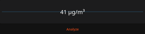

Only question I have is about density. Openhab uses SI units, which is great. Density is displayed in kg*m^-3, I changed state description to use ug*m^-3.
In graphs
Looks like the (very) small value is rounded to 0. Is there a way to multiply the value by, for example 10^9?
