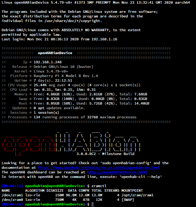

Use the 64bit openhabian. I have it working with oh3 and zram on pi4 8gig
