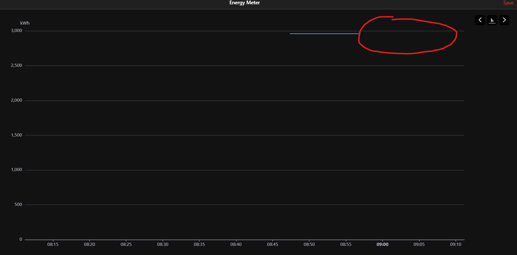

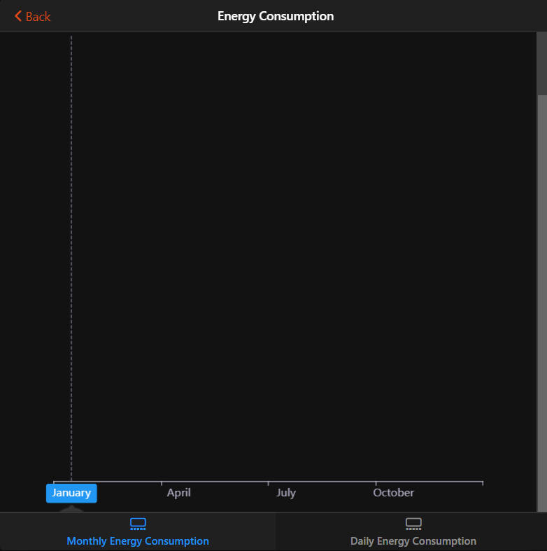

After every reboot, all historic data is empty. I ran the OH backup through openhabian-config which restored all items, all persistence files, everything accordingly. I could chart historic data until a reboot. After a reboot, all historic data is gone. The items start writing new data, and I see chart data from the reboot time to the next shutdown. Then again, all historic data is gone and the last item state is null until a new update comes in.

  • Checked historic item state in charts:
  • Saved /var/log/zram-config/zram-config.log (I saved the file on 8/14/8:20 am after I imported the openhab backup, interestingly the last change in the log file was on 8/13/8:23pm, so yesterday)
  • Saved /var/log/zram-config/zram-config.log:

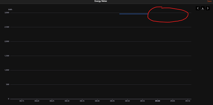

  • Rebooted the pi with sudo reboot
  • Re-installed zram via openhabian-config
  • Re-started openhab via sudo systemctl restart openhab.service
  • Checked historic item state in charts for the last hour (data visible is since restoring the backup):
  • Rebooted openhab with sudo reboot
  • Checked historic item state in charts for the last hour (data after re-enabling zram is gone again):
So yes, it’s definitely zram. Let me know in case you need debug or verbose logs for zram to investigate further.
