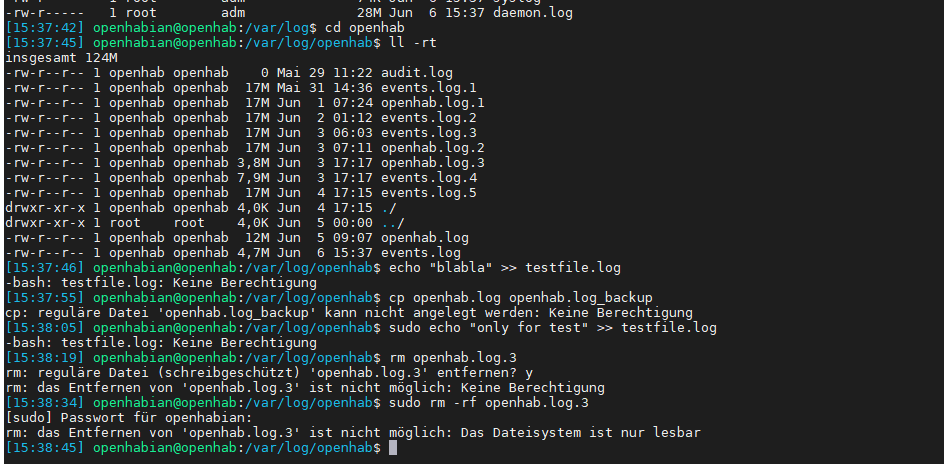

If i want to change/write something into this log directory, the whole directory is read-only.

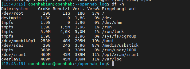

Are you sure? what’s the outputs of zramctl and df -h ?
not sure if the screenshot is exactly after restart of my raspi or before.

but anyway: doesn’t it look strange, that my filesystem (or at least some parts at zram) are readonly:
normally a full file system gives an error with something similar to “no space left on device” or something else but not changing into “read only mode”, even with “sudo” I got the error message that I don’t have mermissions
no screenshots please. What about zramctl ?
now after restart of my raspi everything is OK again (without deleting any logfiles and so on).

[08:02:56] openhabian@openhab:/var/log/openhab$ zramctl --output-all
NAME       DISKSIZE  DATA COMPR ALGORITHM STREAMS ZERO-PAGES TOTAL MEM-LIMIT MEM-USED MIGRATED MOUNTPOINT
/dev/zram1     500M  214M 45,2M lzo-rle         4       3862 99,5M      350M    99,5M       0B /opt/zram/zram1
/dev/zram0     600M    4K   87B lzo-rle         4          0    4K      200M       4K       0B [SWAP]
[08:03:12] openhabian@openhab:/var/log/openhab$
[08:03:28] openhabian@openhab:/var/log/openhab$ df -h
Dateisystem    Größe Benutzt Verf. Verw% Eingehängt auf
/dev/root        29G    9,2G   19G   33% /
devtmpfs        1,8G       0  1,8G    0% /dev
tmpfs           1,9G       0  1,9G    0% /dev/shm
tmpfs           1,9G    1,4M  1,9G    1% /run
tmpfs           5,0M    4,0K  5,0M    1% /run/lock
tmpfs           1,9G       0  1,9G    0% /sys/fs/cgroup
/dev/mmcblk0p1  253M     48M  205M   19% /boot
/dev/sda1        29G     23G  4,6G   84% /media/usbstick
tmpfs           388M       0  388M    0% /run/user/1000
/dev/zram1      469M    199M  235M   46% /opt/zram/zram1
overlay1        469M    199M  235M   46% /var/log
[08:03:31] openhabian@openhab:/var/log/openhab$ du -h
