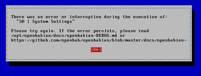

I tried to install, but got an error '…during execution of: “30 | System Settings” ’
I only had a quick look at the document mentioned, … maybe there’s a less painfull solution.
I’m running oh on a raspi 3B+ based on an older openhabianpi image (before march 2018).
uname -r gives me 4.19.66-v7+
What i did:
I switched to master and updated the system.
When trying to install zram, it failed with error shown above. After leaving openhabian-config the console shows

$ systemctl start zram-config
Failed to start zram-config.service: Unit zram-config.service not found.
Any hints?

Try again, there has been a fix to this.
Of course, it always is. But it won’t fix your issue.
@Lionello_Marrelli no need to install from scratch (doesn’t harm, though).

OK
The result looks good, though:
[20:22:24] openhabian@openHABianPi:~$ ls -l /srv/openhab2-logs/openhab.log
-rw-rw-r-- 1 openhab openhab 5106411 Jun 18 19:51 /srv/openhab2-logs/openhab.log
[20:22:42] openhabian@openHABianPi:~$ ls -l /var/log/openhab2/openhab.log
-rw-rw-r-- 1 openhab openhab 5106411 Jun 18 19:51 /var/log/openhab2/openhab.log
[20:22:51] openhabian@openHABianPi:~$ ls -l /srv/openhab2-logs/events.log
-rw-rw-r-- 1 openhab openhab 11169932 Jun 18 20:12 /srv/openhab2-logs/events.log
[20:22:57] openhabian@openHABianPi:~$ ls -l /var/log/openhab2/events.log
-rw-rw-r-- 1 openhab openhab 11169932 Jun 18 20:12 /var/log/openhab2/events.log
[20:23:03] openhabian@openHABianPi:~$ tail /var/log/openhab2/events.log
Do you run some older release ? On my buster, -q is a known option.
quite old, yes.
uname -r tells me 4.19.66-v7+
Distrib is from early 2018 i think (i just looked up: stretch it is).
This is why i asked, if dist-upgrade would be an option.
EDIT:
After restarting openhab because i di see no more updates in the logs, i got lot’s of messages on the webinterface. I did a reboot with oh disabled. Fine. Started oh:
Job for openhab2.service failed because the control process exited with error code.
See "systemctl status openhab2.service" and "journalctl -xe" for details.
Wastebin is not so far away any more.
With zram “uninstalled” via openhabian-config and running an other update which installed java once more, i’m now able to run openhab again.
Do you think, i should give zram another chance an if so: which way? Or should i update to buster before @mstormi?
Sure. Upgrade to buster first, upgrade to latest openhabian, then install ZRAM from the menu.
Or if you want to be on the safe side, reinstall.
Wait a couple of days for the updated image to get released.
Thx for your recommendation.
I’ll go for a fresh install i think. I’ll take some time before and go through all my dirty changes in the dark past and make some more notes to be prepared.
Thank you again for taking your time!
Ok I’m a bit lost on the ZRAM topic. I have installed openHAB version 2.5.2-1 (running on openhabian) and running it for about 4 month with ZRAM enabled on a Raspberry Pi 4 Model B Rev 1.1. I’d like to upgrade to the latest openhabian + openHAB version.
What is the right way to do it with ZRAM being enabled? (I can’t find anything in the first post)
Stop zram-config, update OH, edit /etc/ztab to match latest, reboot
Thank you very much. Should I reinstall ZRAM (in the openhabian config) after updating to the latest openhabian version? Or is that not necessary?
no it isn’t
Thank you very much that did work perfectly. On a system reboot is stopping OH2 and rebooting (sudo reboot) enough or is there a special treatment still necessary? Or is it enough to use just a sudo reboot?
