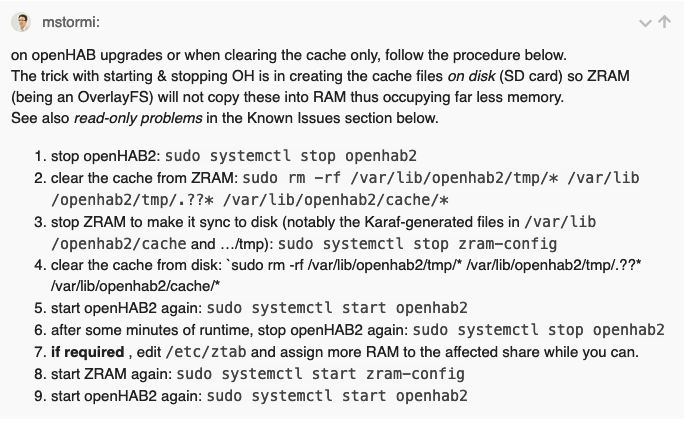

  1. are these steps still valid for clearing the cache?
    I am asking because I noted that you have removed them from the original post (if not, can you inform the steps to do it safely?):
thanks
Yes but that’ll stop OH so I would avoid that, too.
Combine ZRAM with backup (Amanda in openHABian) to save the files on ZRAM of interest (persistence), the rest is irrelevant so no real loss when you lose them.
No, OH cache is no longer on ZRAM (presuming you use a recent definition of ZRAM dirs in ztab, see openHABian config).
