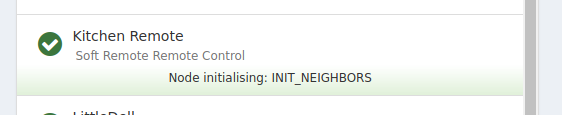

. The similarity to the ZW096 is that once the device is included it can take over 2 hours to finish discovery with me waking it up randomly about every 15 to 30 minutes. If discovery finishes, it will work for about 24 hours and then slip back into discovery again which is where it is now with init_neighbors. Fortunately this time it’s still working, but during previous attempts OpenHAB has stopped receiving scene commands when it enters this state. Mostly what I’m hoping you can help me with is to confirm that this isn’t a systemic issue and that both devices are simply misbehaving on their own. The attached log is me switching on a light while the remote is in the state init_neighbors. Even after the node goes back to sleep init_neighbors remains in Habmin.

It sounds like there’s a disconnect between what’s in the logs and what is being reported by Habmin/Paper UI. Despite being completely discovered Habmin still shows the following:
Strange - I’m not sure how that’s possible, but I will take a look. Is this coincident with the logs showing done (ie this image is definitely taken when the logs are showing (Alive:Done) for the status)?
Yes, nothing has changed since the logs I sent you yesterday showing no discovery activity after a wakeup. Are there any logs I can pull related to how Habmin queries the binding?
HABmin doesn’t query the binding - it gets the data from ESH. When the binding updates the state, it tells ESH the current state. There’s nearly no way that I can see for these to be out of sync.
Have you refreshed the browser (I guess so if it’s been running for a long time, but just thought I’d ask).

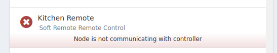

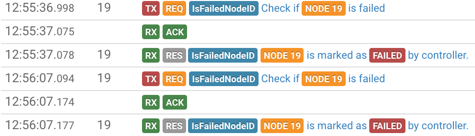

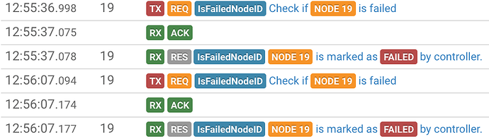

This is caused by the controller reporting that the device is DEAD.
There is a test version of the security binding that bypasses this as this test seems to cause problems. The idea is to refactor this out before merging the security binding into master…
You might want to give it a try - it should avoid this problem at least.
That solved it! All of my devices came right up after installing the testing version. I’ll patiently wait for the merge to master.
