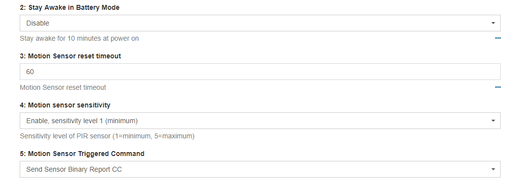

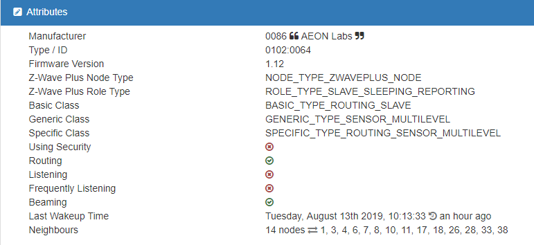

I got a new zw100 this morning and the issue that I am seeing is that whenever the alarm cancels it automatically goes back to ‘ON’ a few seconds later. Has anyone seen this or know what could be causing it. I have another one that I got about a year ago that works just fine.

Switch Kitchen_Motion2 "Kitchen Movement:[MAP(motion2.map):%s]" (gKSensors) {channel="zwave:device:b776346d:node42:alarm_motion"}
Sample of events log.
2019-08-13 06:28:59.590 [vent.ItemStateChangedEvent] - Kitchen_Motion2 changed from ON to OFF
2019-08-13 06:29:02.414 [vent.ItemStateChangedEvent] - Kitchen_Motion2 changed from OFF to ON
2019-08-13 06:30:03.285 [vent.ItemStateChangedEvent] - Kitchen_Motion2 changed from ON to OFF
2019-08-13 06:30:05.399 [vent.ItemStateChangedEvent] - Kitchen_Motion2 changed from OFF to ON
2019-08-13 06:31:06.294 [vent.ItemStateChangedEvent] - Kitchen_Motion2 changed from ON to OFF
2019-08-13 06:31:08.384 [vent.ItemStateChangedEvent] - Kitchen_Motion2 changed from OFF to ON
2019-08-13 06:32:09.287 [vent.ItemStateChangedEvent] - Kitchen_Motion2 changed from ON to OFF
2019-08-13 06:32:11.401 [vent.ItemStateChangedEvent] - Kitchen_Motion2 changed from OFF to ON
2019-08-13 06:33:12.602 [vent.ItemStateChangedEvent] - Kitchen_Motion2 changed from ON to OFF
2019-08-13 06:33:15.405 [vent.ItemStateChangedEvent] - Kitchen_Motion2 changed from OFF to ON
2019-08-13 06:34:16.597 [vent.ItemStateChangedEvent] - Kitchen_Motion2 changed from ON to OFF
2019-08-13 06:34:19.406 [vent.ItemStateChangedEvent] - Kitchen_Motion2 changed from OFF to ON
2019-08-13 06:35:20.606 [vent.ItemStateChangedEvent] - Kitchen_Motion2 changed from ON to OFF
2019-08-13 06:35:23.412 [vent.ItemStateChangedEvent] - Kitchen_Motion2 changed from OFF to ON
2019-08-13 06:36:24.288 [vent.ItemStateChangedEvent] - Kitchen_Motion2 changed from ON to OFF
2019-08-13 06:36:26.395 [vent.ItemStateChangedEvent] - Kitchen_Motion2 changed from OFF to ON
