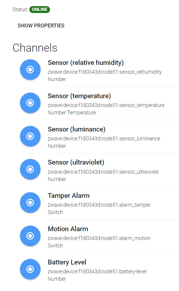

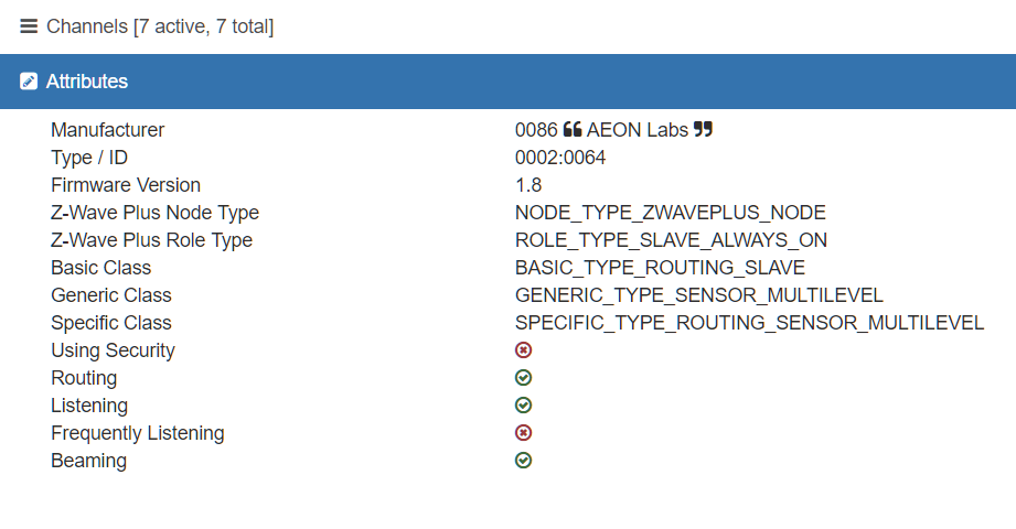

After re-adding a ZW100 MultiSensor 6 (v1.8) the sensor_binary channel is missing.
These are the channels I get:
Any ideas @chris ?
2.4.0-SNAPSHOT Build #1400
243 Active 80 2.4.0.201810221250 ZWave Binding
The channel for sensing motion seems to have changed to ‘alarm_motion’. I had to change all my items.
I think it was, due to the binary and alarm channels are just duplicate of each other.
Yes, this channel is not required and it is best to use the alarm channel.
