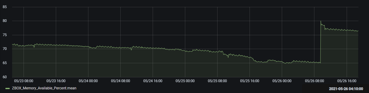

also really not sure what atually runs out of memory .. I see that the RAM is constantly getting more used .. but the graph below shows the %tage of free mem of the machine
so over 60% free mem at the point I see those oom errors.
