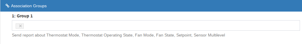

Should I see this in HABmin? Under Association Groups I just see:
https://github.com/openhab/org.openhab.ui.habmin/issues/279
Thanks, so is it just a display issue or is there a problem with the associations also?
Sorry to not give more detail. Yes, it looks to be just a display issue. If you watch the logs, the call goes through and a report comes back, if the device is mains powered. If battery powered, it should be queued.

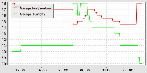

So the problem is I am seeing huge gaps in time where I don’t get any feedback from my stats.
As you can see there were times last night when temp went up and down in steps. However, there are huge gaps like this morning where nothing changed and there was a huge jump from 44.5 to 48^.
The CT100 stat should report any temp change to openhab that is more then .5^F, yet openHAB is not getting the updates. Even more strange I am polling every 5 min so I should at least get the changs via the poll, but that does not happen.

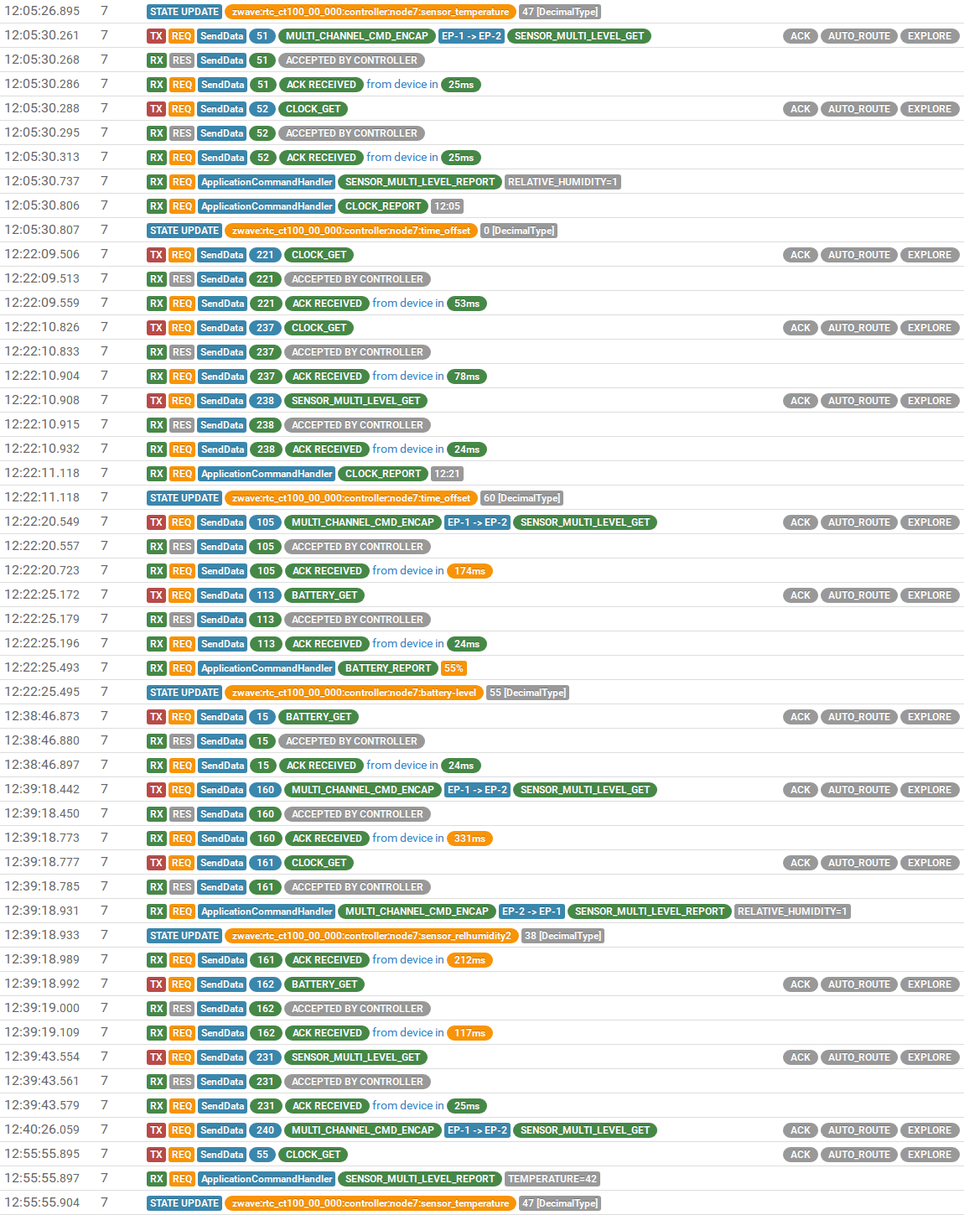

When I look with your very cool log viewer tool I don’t see Polling. So if I look the last hour, I saw two channel updates for sensor_temperature, however my logs show 20 Polling requests.
[root@lisa openhab2]# grep "22-Mar-2018 12" zwave.log |grep "NODE 7:" |grep "sensor_temperature"

They don’t show up in the log viewer, but if I look at the raw logs I see:
22-Mar-2018 12:06:51.559 [DEBUG] [rg.openhab.binding.zwave.handler.ZWaveThingHandler] - NODE 7: Polling...
22-Mar-2018 12:06:51.559 [DEBUG] [rg.openhab.binding.zwave.handler.ZWaveThingHandler] - NODE 7: Polling zwave:rtc_ct100_00_000:controller:node7:sensor_temperature
22-Mar-2018 12:06:51.559 [DEBUG] [.internal.converter.ZWaveMultiLevelSensorConverter] - NODE 7: Generating poll message for COMMAND_CLASS_SENSOR_MULTILEVEL, endpoint 0
22-Mar-2018 12:06:51.559 [DEBUG] [col.commandclass.ZWaveMultiLevelSensorCommandClass] - NODE 7: Creating new message for command SENSOR_MULTILEVEL_GET
22-Mar-2018 12:06:51.559 [DEBUG] [.openhab.binding.zwave.internal.protocol.ZWaveNode] - NODE 7: Encapsulating message, endpoint 0
22-Mar-2018 12:06:51.559 [DEBUG] [.openhab.binding.zwave.internal.protocol.ZWaveNode] - NODE 7: SECURITY not supported
22-Mar-2018 12:06:51.559 [DEBUG] [.openhab.binding.zwave.internal.protocol.ZWaveNode] - NODE 7: Command Class COMMAND_CLASS_SENSOR_MULTILEVEL is NOT required to be secured
22-Mar-2018 12:06:51.560 [DEBUG] [rg.openhab.binding.zwave.handler.ZWaveThingHandler] - NODE 7: Polling zwave:rtc_ct100_00_000:controller:node7:battery-level
22-Mar-2018 12:06:51.560 [DEBUG] [ing.zwave.internal.converter.ZWaveBatteryConverter] - NODE 7: Generating poll message for COMMAND_CLASS_BATTERY endpoint 0
22-Mar-2018 12:06:51.560 [DEBUG] [.openhab.binding.zwave.internal.protocol.ZWaveNode] - NODE 7: Encapsulating message, endpoint 0
22-Mar-2018 12:06:51.560 [DEBUG] [.openhab.binding.zwave.internal.protocol.ZWaveNode] - NODE 7: SECURITY not supported
22-Mar-2018 12:06:51.560 [DEBUG] [.openhab.binding.zwave.internal.protocol.ZWaveNode] - NODE 7: Command Class COMMAND_CLASS_BATTERY is NOT required to be secured
22-Mar-2018 12:06:51.560 [DEBUG] [rg.openhab.binding.zwave.handler.ZWaveThingHandler] - NODE 7: Polling zwave:rtc_ct100_00_000:controller:node7:time_offset
22-Mar-2018 12:06:51.560 [DEBUG] [nding.zwave.internal.converter.ZWaveClockConverter] - NODE 7: Generating poll message for COMMAND_CLASS_CLOCK endpoint 0
22-Mar-2018 12:06:51.560 [DEBUG] [ernal.protocol.commandclass.ZWaveClockCommandClass] - NODE 7: Creating new message for command CLOCK_GET
22-Mar-2018 12:06:51.560 [DEBUG] [.openhab.binding.zwave.internal.protocol.ZWaveNode] - NODE 7: Command Class COMMAND_CLASS_CLOCK is NOT required to be secured
22-Mar-2018 12:06:51.560 [DEBUG] [rg.openhab.binding.zwave.handler.ZWaveThingHandler] - NODE 7: Polling zwave:rtc_ct100_00_000:controller:node7:sensor_relhumidity2
22-Mar-2018 12:06:51.560 [DEBUG] [.internal.converter.ZWaveMultiLevelSensorConverter] - NODE 7: Generating poll message for COMMAND_CLASS_SENSOR_MULTILEVEL, endpoint 2
22-Mar-2018 12:06:51.560 [DEBUG] [col.commandclass.ZWaveMultiLevelSensorCommandClass] - NODE 7: Creating new message for command SENSOR_MULTILEVEL_GET
22-Mar-2018 12:06:51.561 [DEBUG] [.openhab.binding.zwave.internal.protocol.ZWaveNode] - NODE 7: Encapsulating message, endpoint 2
22-Mar-2018 12:06:51.561 [DEBUG] [.openhab.binding.zwave.internal.protocol.ZWaveNode] - NODE 7: Encapsulating message, instance / endpoint 2
22-Mar-2018 12:06:51.561 [DEBUG] [otocol.commandclass.ZWaveMultiInstanceCommandClass] - NODE 7: Creating new message for command MULTI_CHANNEL_ENCAP endpoint 2
22-Mar-2018 12:06:51.561 [DEBUG] [.openhab.binding.zwave.internal.protocol.ZWaveNode] - NODE 7: SECURITY not supported
22-Mar-2018 12:06:51.561 [DEBUG] [.openhab.binding.zwave.internal.protocol.ZWaveNode] - NODE 7: Command Class COMMAND_CLASS_MULTI_CHANNEL is NOT required to be secured
So is the Polling request actually being sent? Also, if I look at the deltas between requests they look longer then the 200 seconds configured, I see one at 12:06:51 and then the next is 12:22:09 with another 3 in the same second.

I guess then that this must be an issue with the device. I’m not sure how it’s configured so can’t really comment on that.
Sorry - I assumed it was a battery device (most thermostats are and I didn’t check). You’re right - wakeup is only for battery devices).
How have you configured polling? You said it was set to 5 minutes?
I don’t know - I don’t really see why it wouldn’t be? You’ve presumably filters the log so it’s hard to confirm, but unless you’ve seen something I’ve missed I don’t see any errors here?
