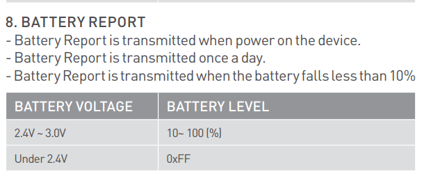

2nd Edit: The Zipato seems (!) to be the same device, at least in that manual there is something mentioned about battery status:
So please check your logs for daily battery updates or if nothing in the logs switch to debug mode and check the logs again. You may use the Zwave Log Viewer for easier reading.
