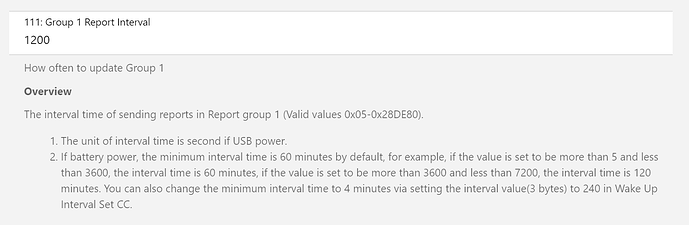

Also for the ZW100 the ‘wakeup interval’ is configured separately from ‘report interval’ (and theshold reports). It is possible to set “report interval< wakeup interval”, but then the reports will only be done at the frequency of the wakeup. Details of this behaviour are described here.

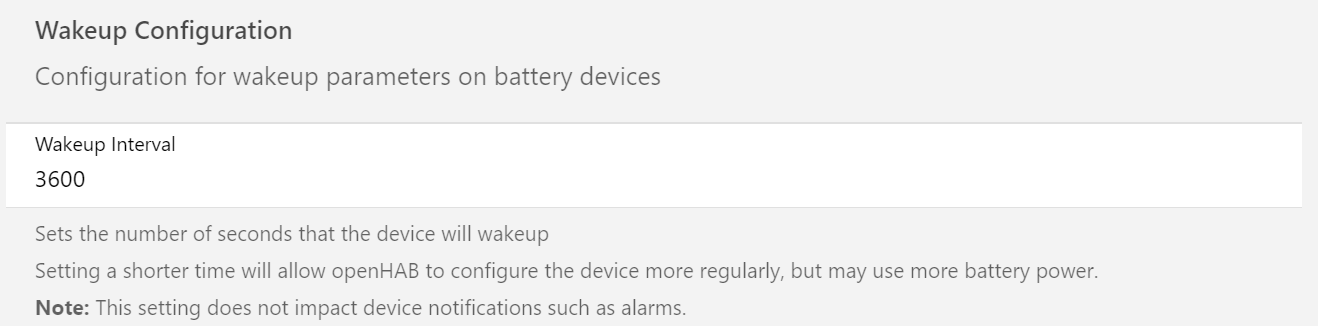

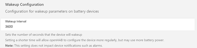

Some screenshots:
Besides, in the UI the maximum wakeup period that can be set for a ZW100 is 3600 s.
