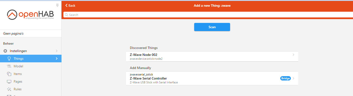

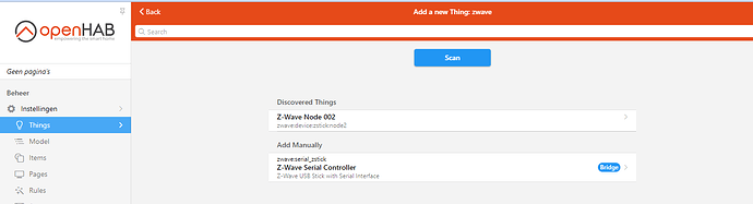

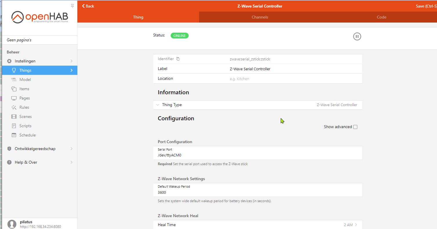

I have added the stick and it is online:
But whenever I open the Thing:
[DEBUG] [g.zwave.internal.ZWaveConfigProvider] - No bridgeUID found in getConfigDescription thing:zwave:serial_zstick:zstick

2023-10-15 14:01:49.120 [DEBUG] [ing.zwave.handler.ZWaveSerialHandler] - NODE 255: Sending REQUEST Message = 01 04 00 41 01 BB
2023-10-15 14:01:49.121 [DEBUG] [ing.zwave.handler.ZWaveSerialHandler] - Message SENT
2023-10-15 14:01:49.122 [DEBUG] [WaveSerialHandler$ZWaveReceiveThread] - Receive Message = 06
2023-10-15 14:01:49.122 [DEBUG] [nal.protocol.ZWaveTransactionManager] - Transaction SendNextMessage started: TID 15: [WAIT_RESPONSE] priority=Controller, requiresResponse=true, callback: 0
2023-10-15 14:01:49.122 [DEBUG] [nal.protocol.ZWaveTransactionManager] - processReceiveMessage input 0<>128 : Message: class=null[0], type=ACK[2], dest=255, callback=0, payload=
2023-10-15 14:01:49.123 [DEBUG] [nal.protocol.ZWaveTransactionManager] - Received msg (0): Message: class=null[0], type=ACK[2], dest=255, callback=0, payload=
2023-10-15 14:01:49.123 [DEBUG] [nal.protocol.ZWaveTransactionManager] - lastTransaction TID 15: [WAIT_RESPONSE] priority=Controller, requiresResponse=true, callback: 0
2023-10-15 14:01:49.123 [DEBUG] [WaveSerialHandler$ZWaveReceiveThread] - Receive Message = 01 09 01 41 D3 16 01 02 02 01 73
2023-10-15 14:01:49.124 [DEBUG] [nal.protocol.ZWaveTransactionManager] - Received msg: ACK
2023-10-15 14:01:49.124 [DEBUG] [nal.protocol.ZWaveTransactionManager] - ZWaveReceiveThread queue empty
2023-10-15 14:01:49.125 [DEBUG] [nal.protocol.ZWaveTransactionManager] - processReceiveMessage input 0<>128 : Message: class=IdentifyNode[65], type=Response[1], dest=255, callback=0, payload=D3 16 01 02 02 01
2023-10-15 14:01:49.125 [DEBUG] [nal.protocol.ZWaveTransactionManager] - Transaction SendNextMessage 1 out at start. Holdoff false.
2023-10-15 14:01:49.126 [DEBUG] [nal.protocol.ZWaveTransactionManager] - Received msg (0): Message: class=IdentifyNode[65], type=Response[1], dest=255, callback=0, payload=D3 16 01 02 02 01
2023-10-15 14:01:49.126 [DEBUG] [nal.protocol.ZWaveTransactionManager] - lastTransaction TID 15: [WAIT_RESPONSE] priority=Controller, requiresResponse=true, callback: 0
2023-10-15 14:01:49.126 [DEBUG] [nal.protocol.ZWaveTransactionManager] - Checking outstanding transactions: 1
2023-10-15 14:01:49.127 [DEBUG] [nal.protocol.ZWaveTransactionManager] - Last transaction: TID 15: [WAIT_RESPONSE] priority=Controller, requiresResponse=true, callback: 0
2023-10-15 14:01:49.127 [DEBUG] [ve.internal.protocol.ZWaveController] - Incoming Message: Message: class=IdentifyNode[65], type=Response[1], dest=255, callback=0, payload=D3 16 01 02 02 01
2023-10-15 14:01:49.128 [DEBUG] [rialmessage.IdentifyNodeMessageClass] - NODE 1: ProtocolInfo
2023-10-15 14:01:49.129 [DEBUG] [rialmessage.IdentifyNodeMessageClass] - NODE 1: Listening = true
2023-10-15 14:01:49.129 [DEBUG] [rialmessage.IdentifyNodeMessageClass] - NODE 1: Routing = true
2023-10-15 14:01:49.130 [DEBUG] [rialmessage.IdentifyNodeMessageClass] - NODE 1: Beaming = true
2023-10-15 14:01:49.130 [DEBUG] [rialmessage.IdentifyNodeMessageClass] - NODE 1: Version = 4
2023-10-15 14:01:49.130 [DEBUG] [rialmessage.IdentifyNodeMessageClass] - NODE 1: FLIRS = false
2023-10-15 14:01:49.131 [DEBUG] [rialmessage.IdentifyNodeMessageClass] - NODE 1: Security = false
2023-10-15 14:01:49.131 [DEBUG] [rialmessage.IdentifyNodeMessageClass] - NODE 1: Max Baud = 40000
2023-10-15 14:01:49.132 [DEBUG] [rialmessage.IdentifyNodeMessageClass] - NODE 1: Basic = BASIC_TYPE_STATIC_CONTROLLER
2023-10-15 14:01:49.132 [DEBUG] [rialmessage.IdentifyNodeMessageClass] - NODE 1: Generic = GENERIC_TYPE_STATIC_CONTROLLER
2023-10-15 14:01:49.132 [DEBUG] [rialmessage.IdentifyNodeMessageClass] - NODE 1: Specific = SPECIFIC_TYPE_PC_CONTROLLER
2023-10-15 14:01:49.133 [DEBUG] [tocol.commandclass.ZWaveCommandClass] - NODE 1: Creating new instance of command class COMMAND_CLASS_NO_OPERATION
2023-10-15 14:01:49.133 [DEBUG] [tocol.commandclass.ZWaveCommandClass] - NODE 1: Command class COMMAND_CLASS_NO_OPERATION, endpoint 0 created
2023-10-15 14:01:49.134 [DEBUG] [tocol.commandclass.ZWaveCommandClass] - NODE 1: Version = 1, version set. Enabling extra functionality.
2023-10-15 14:01:49.134 [DEBUG] [ng.zwave.internal.protocol.ZWaveNode] - NODE 1: Adding command class COMMAND_CLASS_NO_OPERATION to the list of supported command classes.
2023-10-15 14:01:49.135 [DEBUG] [tocol.commandclass.ZWaveCommandClass] - NODE 1: Creating new instance of command class COMMAND_CLASS_BASIC
2023-10-15 14:01:49.136 [DEBUG] [tocol.commandclass.ZWaveCommandClass] - NODE 1: Command class COMMAND_CLASS_BASIC, endpoint 0 created
2023-10-15 14:01:49.136 [DEBUG] [ng.zwave.internal.protocol.ZWaveNode] - NODE 1: Adding command class COMMAND_CLASS_BASIC to the list of supported command classes.
2023-10-15 14:01:49.137 [DEBUG] [e.internal.protocol.ZWaveTransaction] - TID 15: Transaction COMPLETED
2023-10-15 14:01:49.137 [DEBUG] [nal.protocol.ZWaveTransactionManager] - NODE 255: Response processed after 15ms
2023-10-15 14:01:49.138 [DEBUG] [nal.protocol.ZWaveTransactionManager] - NODE 255: TID 15: Transaction completed
2023-10-15 14:01:49.138 [DEBUG] [nal.protocol.ZWaveTransactionManager] - NODE 255: notifyTransactionResponse TID:15 DONE
2023-10-15 14:01:49.139 [DEBUG] [nal.protocol.ZWaveTransactionManager] - ZWaveReceiveThread queue empty
2023-10-15 14:01:49.139 [DEBUG] [nal.protocol.ZWaveTransactionManager] - TID 15: Transaction event listener: DONE: DONE -> UNINTIALIZED
2023-10-15 14:01:49.139 [DEBUG] [nal.protocol.ZWaveTransactionManager] - Transaction SendNextMessage 0 out at start. Holdoff false.
2023-10-15 14:01:49.140 [DEBUG] [alization.ZWaveNodeInitStageAdvancer] - NODE 1: Node Init response (0) org.openhab.binding.zwave.internal.protocol.ZWaveTransactionResponse@484abc
2023-10-15 14:01:49.140 [DEBUG] [alization.ZWaveNodeInitStageAdvancer] - NODE 1: Node Init transaction completed with response COMPLETE
2023-10-15 14:01:49.141 [DEBUG] [alization.ZWaveNodeInitStageAdvancer] - NODE 1: Node advancer: FAILED_CHECK - Controller - terminating initialisation
2023-10-15 14:01:49.141 [DEBUG] [alization.ZWaveNodeInitStageAdvancer] - NODE 1: Node advancer - advancing to DONE
2023-10-15 14:01:49.142 [DEBUG] [l.initialization.ZWaveNodeSerializer] - NODE 1: Serializing to file /var/lib/openhab/zwave/network_fde811aa__node_1.xml
2023-10-15 14:01:49.407 [DEBUG] [g.zwave.internal.ZWaveConfigProvider] - No bridgeUID found in getConfigDescription thing:zwave:serial_zstick:zstick
I have to admit that I am a bit desperate at the moment I think I tried everything and did everything right. I am no Linux wizard, so I would really need some guidance here.
