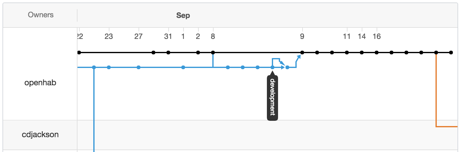

Hi Chris can you confirm this binding is an older one prior to merging with the snapshot?
251 │ Active   │  80 │ 2.4.0.201809081506     │ ZWave Binding
Regarding UoM or what? Took me a five seconds forum search:
Zwave as per my post. I didnt see any mention of zwave in your linked post.
I guess you are referring to the merging of the development branch with security etc? That was done on the 9th Sep by the looks of it, so the version you reference was probably the last before the merge.
Thank you Chris.
