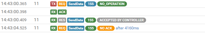

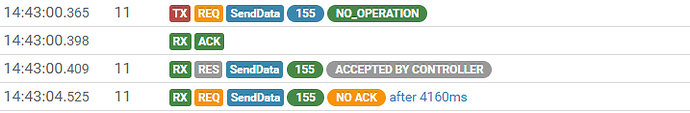

I see a lot of timeouts from node 11 so there is something wrong with that device! You can try a reset/reinclude to see if it resolves it, but the problem is the low level communication, and not the binding.
Other devices in the log appear ok.
