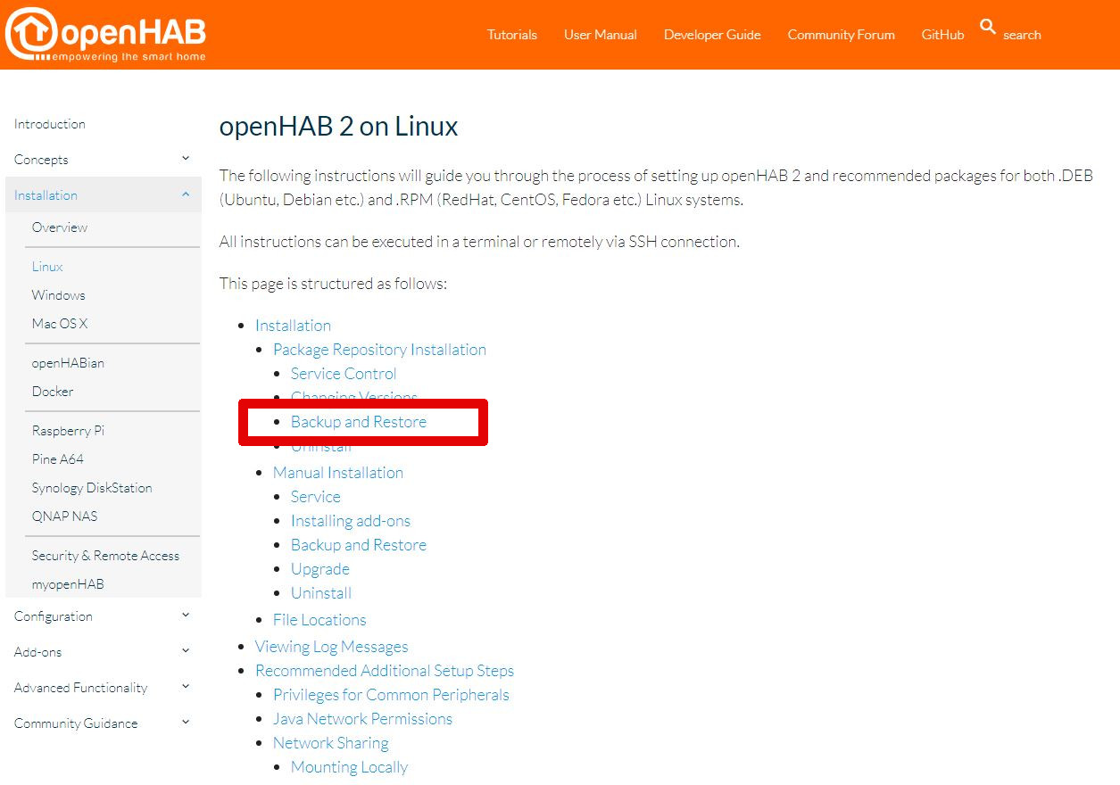

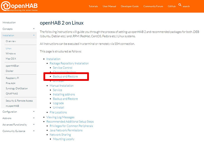

It does not help to point to documents which do not contain any information on how a backup is done.
The Amada backup is also of no help as I do not even understand the questions it is asking during install like “What is the directory to store backups”. How to define a path in linux? Does the folder have to exist?

Sorry, but when I follow the link I gave you I get:

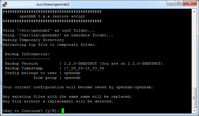

Anyway - when tried to restore at a different SD card, I got the following errors:
[14:49:14] pi@PI3:/usr/share/openhab2$ sudo systemctl stop openhab2.service
[14:49:20] pi@PI3:/usr/share/openhab2$ sudo ./runtime/bin/restore /etc/openhab2/Backup20170929.zip
       openHAB 2.x.x restore script
Using '/etc/openhab2' as conf folder...
Using '/var/lib/openhab2' as userdata folder...
Making Temporary Directory
Extracting zip file to temporary folder.
 Backup Information:
 Backup Version         | 2.2.0-SNAPSHOT (You are on 2.2.0-SNAPSHOT)
 Backup Timestamp       | 17_09_29-11_29_10
 Config belongs to user | openhab
             from group | openhabian
Your current configuration will become owned by openhab:openhabian.
Any existing files with the same name will be replaced.
Any file without a replacement will be deleted.
Okay to Continue? [y/N]: y
Moving system files in userdata to temporary folder
Deleting old userdata folder...
Restoring system files in userdata...
Deleting old conf folder...
Restoring openHAB with backup configuration...
chown: ungültige Gruppe: „openhab:openhabian“
Failed to change userdata permissions to openhab:openhabian
Any idea?
The restore should have completed regardless of the error, can you confirm this for me?
The script is complaining that your old group “openhabian” doesn’t exist anymore. Although I’m not convinced that this should have been anything other than “openhab”. For now you should make sure openHAB is in-charge of it’s own folders just in case.
sudo chown -R openhab:openhab /var/lib/openhab2
sudo chown -R openhab:openhab /etc/openhab2
I’ll work on updating the script so that it relies on a default if old users/groups do not exist.
