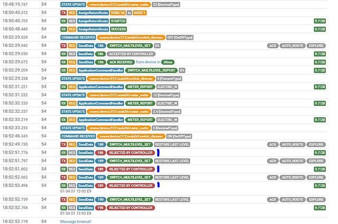

I am still trying to Identify the cause of Those hick ups with Rejects and CANs in my Network and esp. With Qubino Dimmers.
Anything in my log in above post that would Look Strange to you?
Thanks and Cheers
I’m not really sure what is happening…
In the above code, there should be an ACK almost immediately after a frame is sent. This doesn’t get received, so the binding aborts the transaction. This abort does get an ACK!
This happens a few times, so I’m it’s not just a one off. :confounded:
Have you reset the controller (ie removed the stick and put it back, and restarted the binding)? It’s about the only thing I can really think of to do as I’m not sure what would cause the controller to not respond with the ACK.
