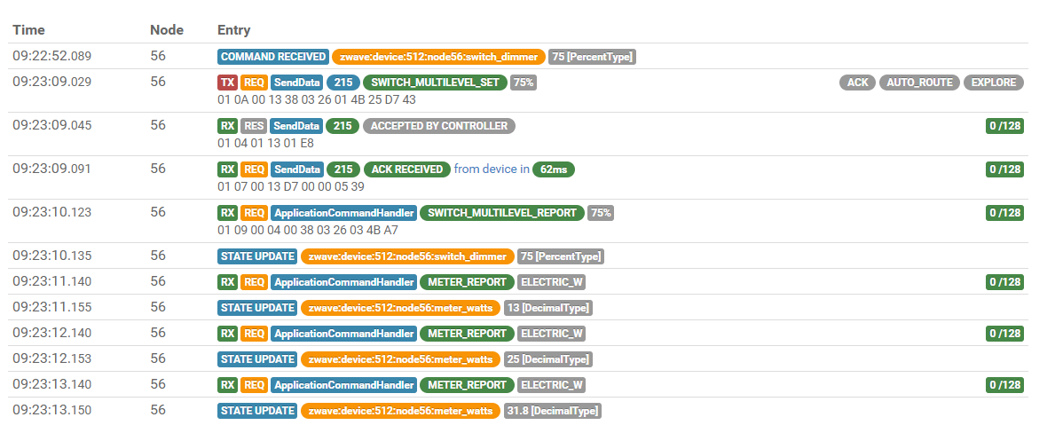

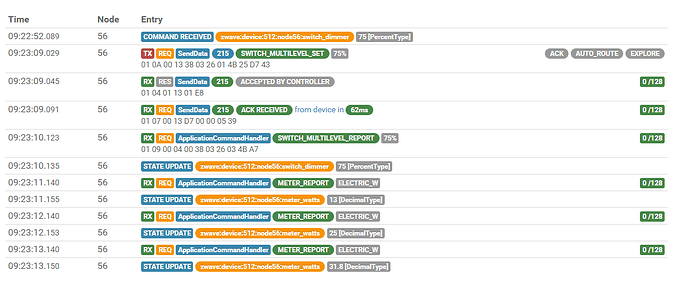

I see a extremely different performance on my zwave devices.
a lot of times it is just instantly reacting to commands … but sometimes the same device takes many seconds to respond. (I have a dense mesh network with ~80 nodes)
the log below is a qubino dimmer actor which I just turned off and on a few times .. out of like 10 commands one gets very slow… the slow one is attached.
do you see a reson in the log for the performance decrease?

You’re referring to the ~17 seconds from when the command is received until the binding sends the MULTILEVEL_SET, right?
Is there any activity with the other nodes during this time (i.e. are you filtering the display on node 56)?
Correct.
The JPG from @chris log viewer is filtered.
The attached log (TXT file) is unfiltered and the Full log for that Time Slot with all Traffic from Zwave (Debug)

Ok, that’s what I suspected. I’m assuming that there are transactions in play with other nodes that are blocking the node 56 transactions. Those other transactions are possibly timing out, which easily could introduce multiple-second delays (the timeout is 5 seconds).

Looks like there are some issues with node 50. That’s what appears to be causing the delay in the transmission of the command to node 56. I also don’t know what would be causing the CANs.
