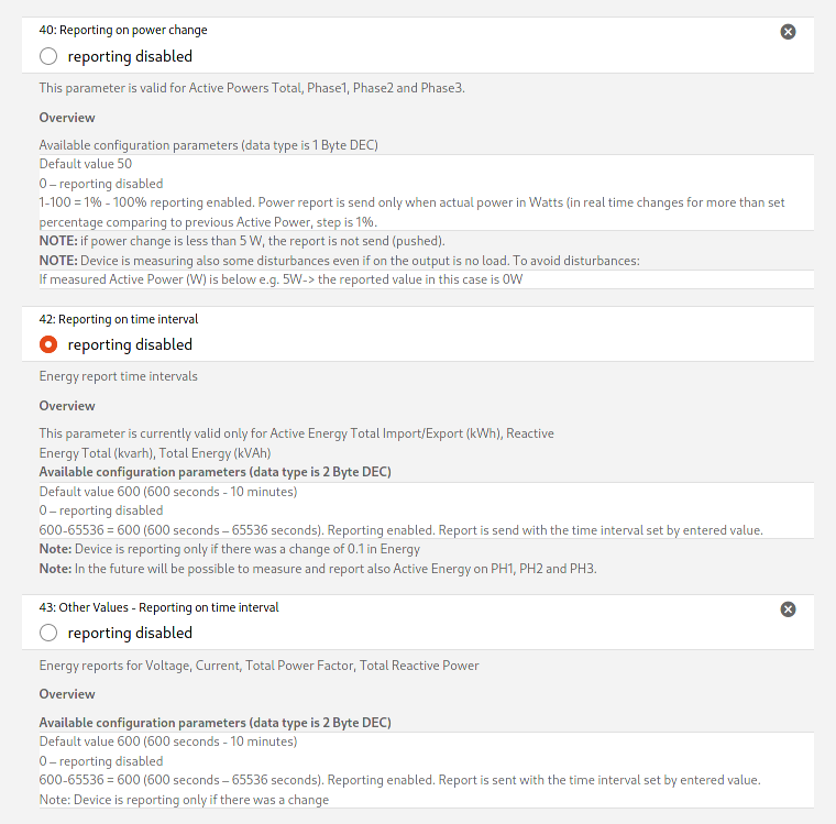

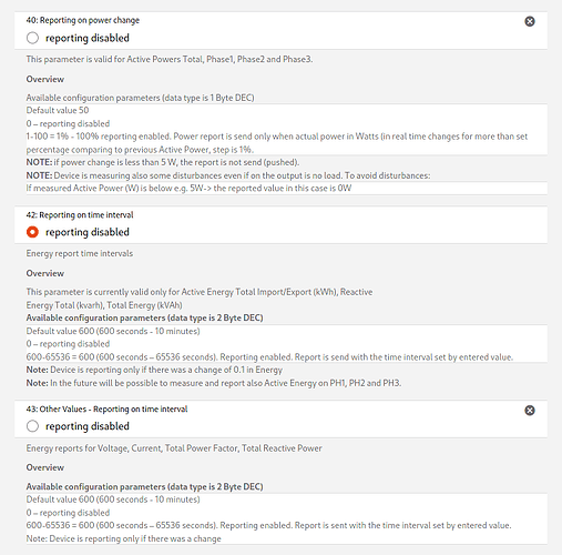

I wanted to change reporting intervalls (40,42,43) which should be integer (input fields) but instead a radio button is shown.
Is this a binding issue or an openhab issue?

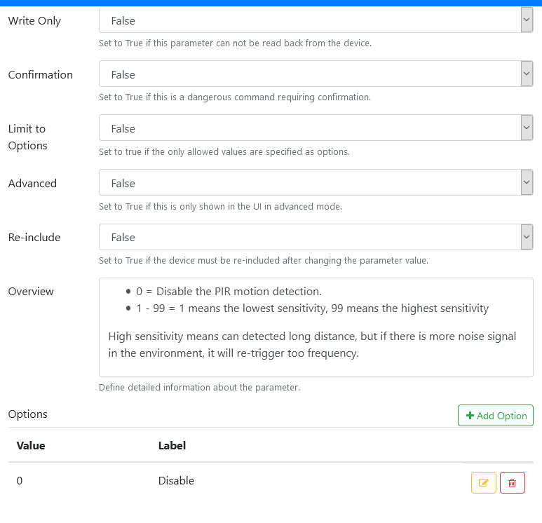

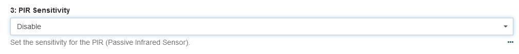

I am seeing the same issue on one of my motion sensors :
If only one option is available there is no chance to enter any values.
As this did work on openHAB2, the question is: binding issue or gui issue? @chris ?

I would think that if the UI is showing a radio button for an integer value, and it works on OH2, then probably this is a UI issue.
If I look at the definition for parameter 40, it looks fine to me and I would think it should be presented as an integer -:

sihui
(SiHui)
December 18, 2020, 11:22am
12
chris:
and it works on OH2
I thought it works … I did not change parameters on my devices since three years, but I tried now and: it does not work
Edit: I suspected the missing “min value” in the OP device
to cause the problem, but the parameter I showed in the screenshot for my device does have a min value and still does not work.

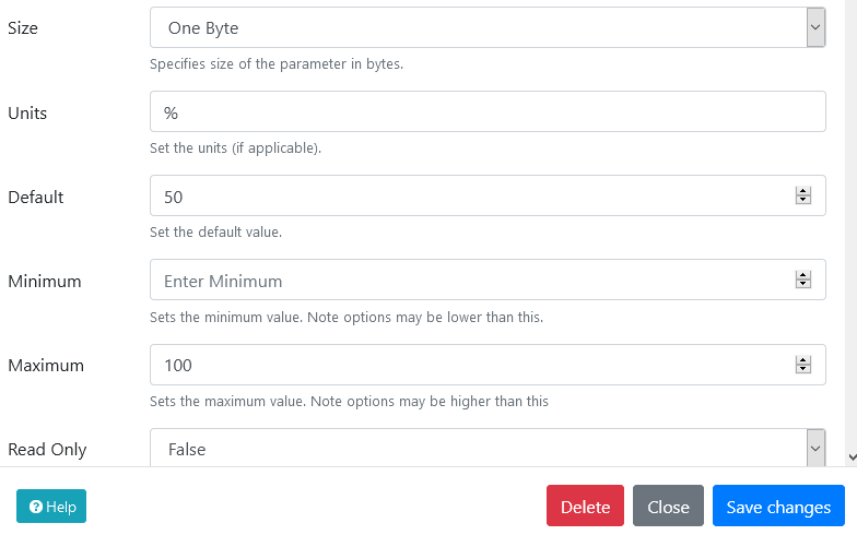

https://opensmarthouse.org/zwavedatabase/308
On the new site minimum of 0 shows up as empty. I assume limit to options only is false too.

Correct - it’s annoying and I’ve not worked out how to change this .
sihui:
You can however see from the information above that the export into the XML uses minimum of 0.
<parameter name="config_40_1" type="integer" groupName="configuration"
min="0" max="100">
ysc
(Yannick Schaus)
December 18, 2020, 3:48pm
15
chris:
any thoughts. I think you already fixed some things like this
Yes that’s one of those cases of range-constraint-plus-options-that-may-or-may-not-fall-into-that-range. It was not handled properly i.e. the number field was refusing to allow values outside its range, so if there’s a min/max/step and also options, they are not enforced at all, until we find a more permanent solution.

16
That rendering makes me think limitToOptions is set to true. Otherwise you’d have a text field instead of this.

ysc:
Nope:
