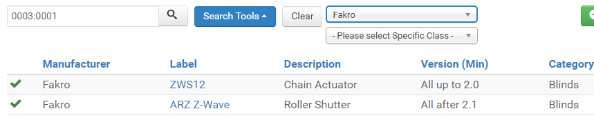

Yes, that manufacruter has used the same device type and id numbers for various devices. That combination, along with the manufacturer id is the only way of identifying Z-Wave devices
We have no way of properly supporting these devices.

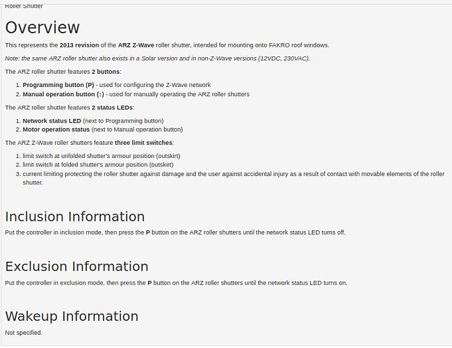

According to our database this could happen, depending on firmware version. It the vendor has reused device type/id pairs there is not really anything we can do.
What version of firmware does your device have?
Firmware version is 4.13 in all four cases.
So then it’s as Bruce said - it seems that there’s an overlap in the device type/id and the version. We could limit the version in the ARZ for (say) 3.255, so that should make your device work again and we can see if there are people with overlapping versions then…
@Bruce_Osborne - any objections? Are you aware of anyone with this ARZ device with a high version number? I note that in the database it states that this is the 2013 version, so hopefully there’s not a wide range of versions!
I am ignorant of Fibaro devices Sorry. I assume that would require a new database entry for the newer firmware ZWS12?` We should try to get the latest manual & XML file to have the most accurate entry.
It’s not Fibaro - it’s Fakro. I suspect the same is still true though? :slight_smile:
I also know nothing about them, but just wanted to make sure that you weren’t aware of any other discussion about this? (@sihui - same question)
If not, I’d suggest to change the version on the ARZ, then create a new version of the ZWS12 starting at (say) 4 and copy over the configuration. Maybe @robb01 can spend a few minutes to help copy over all the overview type information in the general device info?
