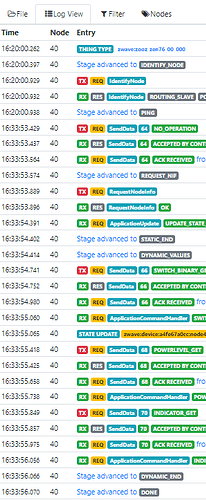

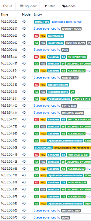

See the log viewer example from file (restart):
3) WAIT_RESPONSE is not good. It means the controller has not ack’ed the message. I think there is 2 seconds for that and 5 seconds total for WAIT_REQUEST. WAIT_REQUEST means the node hasn’t responded. I could look at a log for you if you wish.

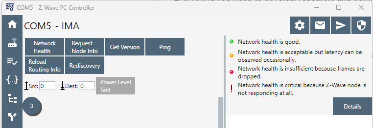

With 90 nodes a zniffer might help. Also the Silabs tool as well as the Aeotec tool referenced in the posting can do a node health checks.
I’ve been using the Silabs tool for basic troubleshooting, and OTA updates. I haven’t spent too much time looking at it yet. I previously had a product named “Zwave Toolbox” which sniffed the network a bit but it’s a pain to use and it doesn’t work well. I’ll look into a 700 series controller for sure now that I know they’re supported, thanks to all those who worked on supporting the new controllers!

Thanks garyfree, I generally use another tool to do inclusion, exclusion, and for some configuration settings as those tools give me immediate feedback and very granular control. I’ve been using the Silicon Labs Simplicity Studio Z-Wave PC Controller recently with good results. I have a new Z-Wave stick on order to assist with the troubleshooting for now.
