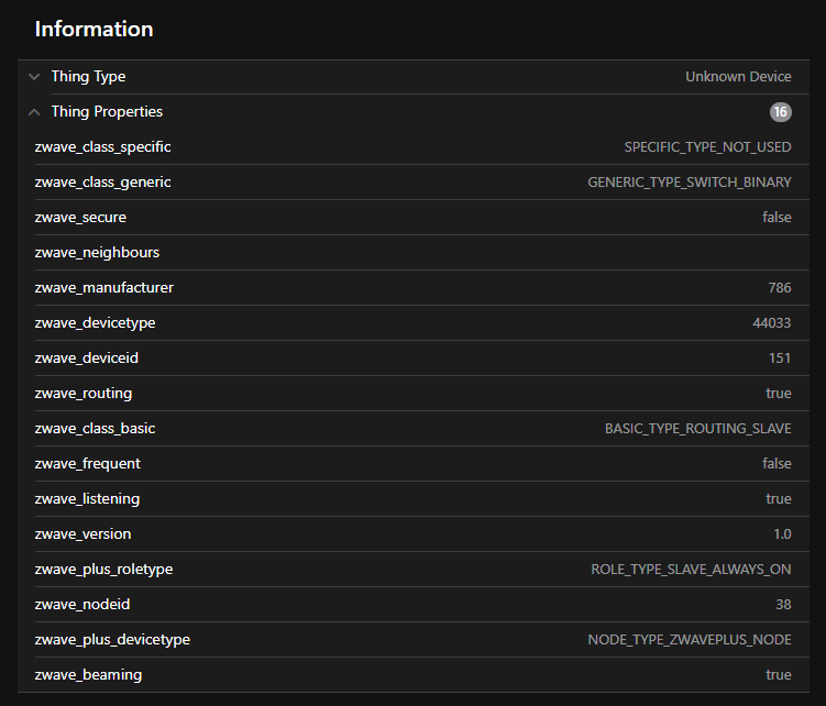

I am having an issue with a z-wave device MP21ZD single switch that I was able to add, but within the binding there are no channels and the ThingType is “unknown device”.

Ok., but I got what I was looking for. More than you want to know: Zwave devices are identified MFG and by Type:id. Yours are 786:44033:151. In hex (if my conversions are correct) is 0312:AC01:0097. The DB entry for MP21ZD is here. OpenSmartHouse Z-Wave Device Database and is 0312:FF01:FF0D. What does the device that was identified look like? Is it 786:65281:65293?
If I am looking at the right device, and they appear identical in your manuals the TYPE:ID AC01:0097 needs to be added to the DB for your second device to be recognized.

No problem. You can just add the type:id (in hex) with a comma after the other type:id if all the parameters, etc. look the same. The blog describes how to get write access, if you do not have that already.
