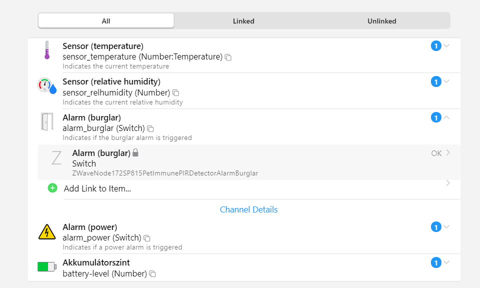

Sorry for the late reply just I was doing the testing.
I have installed the snaphot version of Zwave binding and database roll out was succesfull. Many thanks for that! Now all channels are operational:
All channels are refreshing values. However Burglar channel does not change status when it senses motion. Here is the Zwave trace about status change:

I was checking 3 motion sensors XML to compare this section: Everspring SP515 (this one) SP817 and Aeon Multisensor 6 (ZW100).
SP815:
</channel>
-<channel id="alarm_burglar" typeId="alarm_burglar">
<label>Alarm (burglar)</label>
-<properties>
<property name="binding:*:OnOffType">COMMAND_CLASS_ALARM;type=BURGLAR</property>
</properties>
</channel>
SP817:
</channel>
-<channel id="alarm_motion" typeId="alarm_motion">
<label>Motion Alarm</label>
-<properties>
</properties>
</channel>
ZW100:
</channel>
-<properties>
<property name="binding:*:OnOffType">COMMAND_CLASS_ALARM;type=BURGLAR, event=8</property>
</properties>
</channel>
I see two differences. Label of the channel, and SP815 operates with event=8 like ZW100.
In ZW100 evemt=8 has one additional data – ,event=8:
-<properties>
</properties>
May be that is the reason that event is not recognized. Where should I continue testing? Shall we change the database or I can try to change locally?
