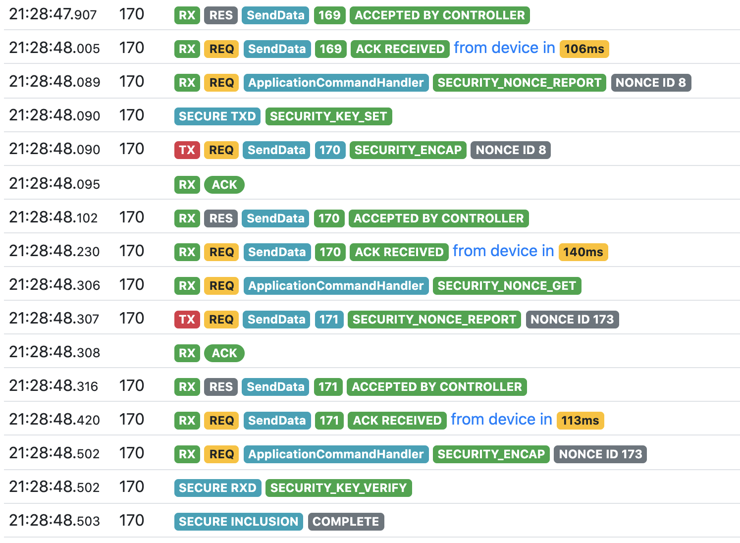

Here it is. I have turned off secured inclusion and I was pushing button during inclusion.
But I’m not sure how to wake it up as it has not written in the manual. Just inclusion, exclusion and device reset.
So secure inclusion was still active, but at least it completed ok this time.

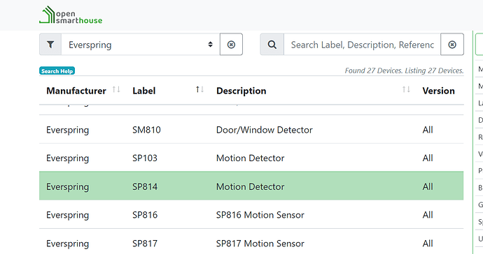

The other issue is the device is in the OH zwave database, but in a modified state. Whoever, did the initial set-up did not press “Request review” AND it looks like this is the original edit, so it is NOT in the Zwave binding you are using. Modified devices are excluded from the biweekly builds.

This is being done by @kovacsi2899 but until there is an XML file created for the device, we can’t create the database. He created this manually which is not a good idea. Also, having a database entry will not in any way help here - what is needed is the discovery to complete - the database is not involved in this at all.
Thanks for the clarification on that. I thought maybe it was set up some time ago and just not reviewed. again, trying to help, but not get in the way.

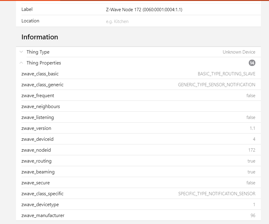

This time binding recognized the device manufacturer and data. No channel created unfortunatelly. Now as device is recognized I have a hope that correct XML will be created by the binding. System is always recreating the XMLs. I do not know what’s behind. All of my devices has right XML except this one. So I keep trying and as soon as I have result I post.
