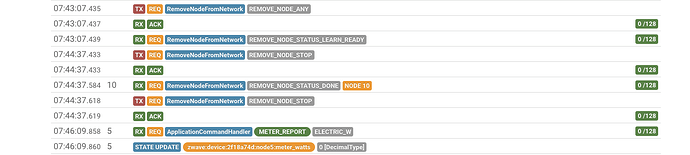

I did the same thing again, set ZWave to exclusion via habmin. Went down to cellar and gave the device three clicks in 3 seconds to initiate exlusion. Guess what… again node 10 was excluded.
2019-03-13_diag_zwave
instead of node 5.

Well, as you can see in the log - this is what is reported by the controller, so I can’t really see how the binding made it do that can you?
On looking at this further, it looks like there should be NO device removed from the controller in the log you show here (I can’t actually view the text log so I’m just going on the image). If a node is removed, there should have been another message before the DONE, but if it is removed from the controller, then it is solely down to the controller to do this - the binding cannot do this even if it wanted to if the device is still working.
Following is directly from the log:
2019-03-13 07:44:37.585 [DEBUG] [serialmessage.RemoveNodeMessageClass] - Remove Node: Done.
2019-03-13 07:44:37.586 [DEBUG] [ding.zwave.handler.ZWaveThingHandler] - NODE 10: Got an event from Z-Wave network: ZWaveInclusionEvent
2019-03-13 07:44:37.597 [DEBUG] [al.protocol.ZWaveInclusionController] - Inclusion event: Current state ExcludeFail, new event ExcludeDone
2019-03-13 07:44:37.597 [DEBUG] [serialmessage.RemoveNodeMessageClass] - Ending EXCLUSION mode.
In the log it states exclusion failed, but it received one and I saw in habmin, that the node 10 was flagged excluded. Sadly I didn’t make a screenshot of it. :frowning:
And not node 5 as should have been. As I stated in the first message this happened twice. the same way. It was effectivly not excluded from the controller. But it does not work as I would expect it to do.
Or something else of what I currently not think of.

So, I can only restate what I said earlier. The exclusion is performed by the controller. All the binding does is to put the device into exclude mode. Here, I wouldn’t have expected any exclusion at all since there is no ExcludeSlaveFound message, so there might be a bug here in the binding.
However, the fact that the controller did not find node 5 to exclude is solely an issue between the controller and the device. The binding cannot exclude specific devices like this.
Can you provide the full exclusion log - not just the last message. It started 30 seconds before this…
No - it doesn’t. The of states that the internal state machine was in ExcludeFailed state - that is actually normal at the end of the exclusion.

2019-03-13 07:44:37.432 [DEBUG] [al.protocol.ZWaveInclusionController] - Inclusion timer at ExcludeStart
2019-03-13 07:44:37.432 [DEBUG] [serialmessage.RemoveNodeMessageClass] - Ending EXCLUSION mode.
2019-03-13 07:44:37.432 [DEBUG] [nal.protocol.ZWaveTransactionManager] - NODE 255: Added 276 to queue - size 1
2019-03-13 07:44:37.432 [DEBUG] [nal.protocol.ZWaveTransactionManager] - Transaction SendNextMessage 0 out at start. Holdoff false.
2019-03-13 07:44:37.432 [DEBUG] [wave.internal.protocol.SerialMessage] - Assembled message buffer = 01 05 00 4B 05 27 93
2019-03-13 07:44:37.433 [DEBUG] [ing.zwave.handler.ZWaveSerialHandler] - NODE 255: Sending REQUEST Message = 01 05 00 4B 05 27 93
2019-03-13 07:44:37.433 [DEBUG] [ing.zwave.handler.ZWaveSerialHandler] - Message SENT
2019-03-13 07:44:37.433 [DEBUG] [WaveSerialHandler$ZWaveReceiveThread] - Receive Message = 06
2019-03-13 07:44:37.433 [DEBUG] [nal.protocol.ZWaveTransactionManager] - Transaction SendNextMessage started: TID 276: [WAIT_REQUEST] priority=Controller, requiresResponse=true, callback: 39
2019-03-13 07:44:37.434 [DEBUG] [nal.protocol.ZWaveTransactionManager] - processReceiveMessage input 0<>128 : Message: class=null[0], type=ACK[2], dest=255, callback=0, payload=
2019-03-13 07:44:37.434 [DEBUG] [nal.protocol.ZWaveTransactionManager] - Received msg (0): Message: class=null[0], type=ACK[2], dest=255, callback=0, payload=
2019-03-13 07:44:37.435 [DEBUG] [nal.protocol.ZWaveTransactionManager] - lastTransaction TID 276: [WAIT_REQUEST] priority=Controller, requiresResponse=true, callback: 39
2019-03-13 07:44:37.435 [DEBUG] [nal.protocol.ZWaveTransactionManager] - Received msg: ACK
2019-03-13 07:44:37.435 [DEBUG] [nal.protocol.ZWaveTransactionManager] - ZWaveReceiveThread queue empty
2019-03-13 07:44:37.435 [DEBUG] [nal.protocol.ZWaveTransactionManager] - Transaction SendNextMessage 1 out at start. Holdoff false.
2019-03-13 07:44:37.584 [DEBUG] [WaveSerialHandler$ZWaveReceiveThread] - Receive Message = 01 07 00 4B 27 06 0A 00 98
2019-03-13 07:44:37.584 [DEBUG] [nal.protocol.ZWaveTransactionManager] - processReceiveMessage input 0<>128 : Message: class=RemoveNodeFromNetwork[75], type=Request[0], dest=6, callback=39, payload=27 06 0A 00
2019-03-13 07:44:37.585 [DEBUG] [nal.protocol.ZWaveTransactionManager] - Received msg (0): Message: class=RemoveNodeFromNetwork[75], type=Request[0], dest=6, callback=39, payload=27 06 0A 00
2019-03-13 07:44:37.585 [DEBUG] [nal.protocol.ZWaveTransactionManager] - lastTransaction TID 276: [WAIT_REQUEST] priority=Controller, requiresResponse=true, callback: 39
2019-03-13 07:44:37.585 [DEBUG] [nal.protocol.ZWaveTransactionManager] - Checking outstanding transactions: 1
2019-03-13 07:44:37.585 [DEBUG] [nal.protocol.ZWaveTransactionManager] - Last transaction: TID 276: [WAIT_REQUEST] priority=Controller, requiresResponse=true, callback: 39
2019-03-13 07:44:37.585 [DEBUG] [ve.internal.protocol.ZWaveController] - Incoming Message: Message: class=RemoveNodeFromNetwork[75], type=Request[0], dest=6, callback=39, payload=27 06 0A 00
2019-03-13 07:44:37.597 [DEBUG] [nal.protocol.ZWaveTransactionManager] - NODE 255: Added 277 to queue - size 1
2019-03-13 07:44:37.597 [DEBUG] [nal.protocol.ZWaveTransactionManager] - Transaction SendNextMessage 1 out at start. Holdoff false.
2019-03-13 07:44:37.598 [DEBUG] [al.protocol.ZWaveInclusionController] - ZWave controller end exclusion
2019-03-13 07:44:37.598 [DEBUG] [ve.internal.protocol.ZWaveController] - ZWaveController include done
2019-03-13 07:44:37.615 [DEBUG] [nal.protocol.ZWaveTransactionManager] - TID 276: Advanced to DONE
2019-03-13 07:44:37.616 [DEBUG] [nal.protocol.ZWaveTransactionManager] - NODE 255: Response processed after 183ms
2019-03-13 07:44:37.616 [DEBUG] [nal.protocol.ZWaveTransactionManager] - NODE 255: TID 276: Transaction completed
2019-03-13 07:44:37.616 [DEBUG] [nal.protocol.ZWaveTransactionManager] - NODE 255: notifyTransactionResponse TID:276 DONE
2019-03-13 07:44:37.617 [DEBUG] [nal.protocol.ZWaveTransactionManager] - ZWaveReceiveThread queue empty
Regards
Stefan
