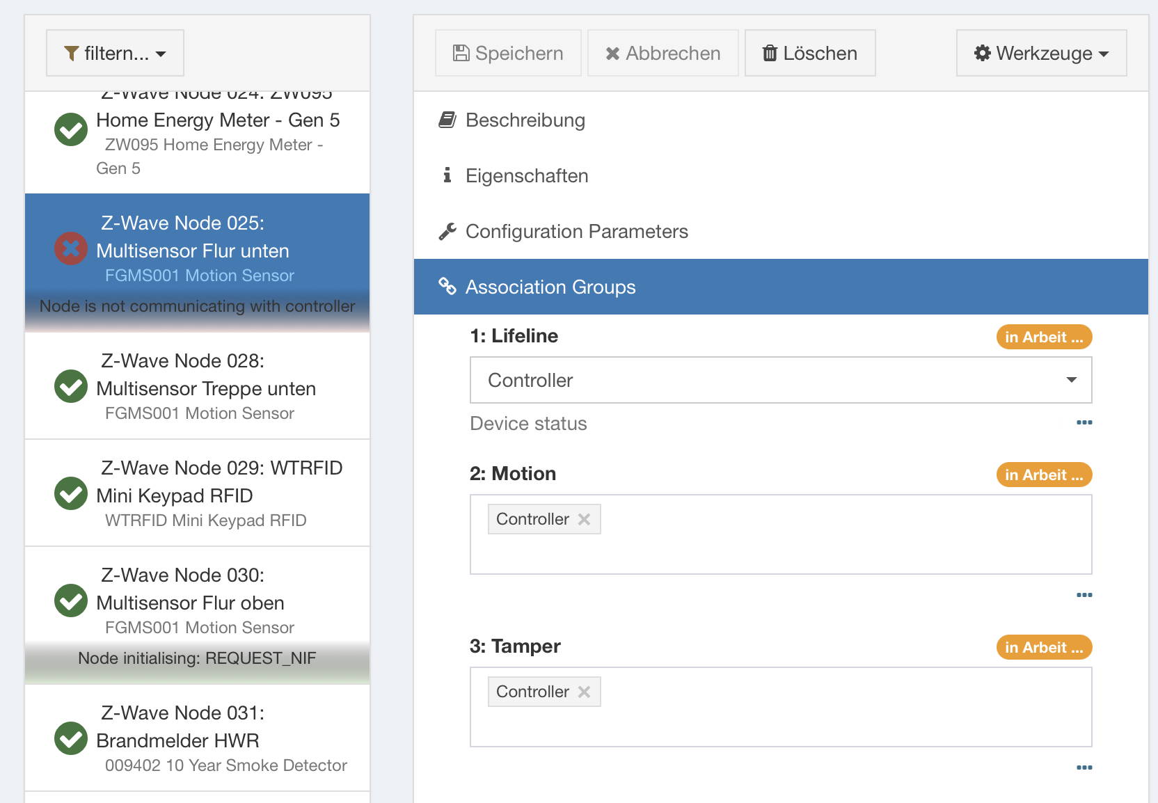

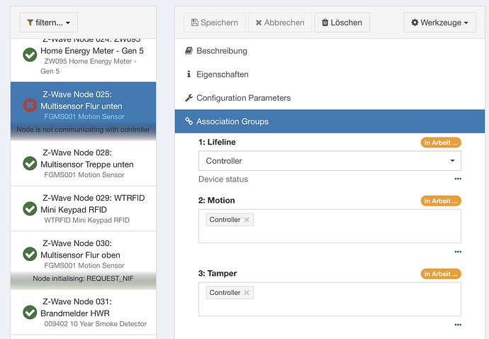

I have recurring problems with FGMS001 Motion Sensors (in total 11).
Since I installed those (step-wise) approx. 3 years ago, I see the following behavior, basically across all my 11 sensors:
  • A sensor is not working any longer, i.e. it doesn’t send Motion Alarms any more, even it has sufficient battery.
  • Habmin marks the sensor with “Node is not communicating with controller”
This happens in the meanwhile every other week. It is always a different sensor. In the meanwhile I believe there is a time-related bug in Fibaro’s firmware, that triggers the issue after X months of inclusion…
The only ways for me to fix this issue is, that I
a) try to re-establish association to the controller (which seems to got lost) and if this doesn’t work
b) to declare the node as dead, remove it from the controller and then include it again.
Today, at 11am CET I observed a VERY strange thing. All FGMS001 sensors stopped reporting motion alarms. Two of those are again are reported by Habmin as “Node is not communicating with controller”. Other Zwave devices (e.g. roller shutter) working fine.
Edit: In the meanwhile the third FGMS001 has died (“Node is not communicating with controller”)… Node 35…
So, there is a very, very strange thing going on with the FGMS001 sensors.
I have no clue how to fix this permanently.
Does anybody observed something similar or has a hint what I could do?
Many thanks for your help
Bodo
P.S.: See attached screenshots for illustration of the problem.Bildschirmfoto 2020-12-09 um 17.29.02 Bildschirmfoto 2020-12-09 um 17.27.52 Bildschirmfoto 2020-12-09 um 17.26.32
