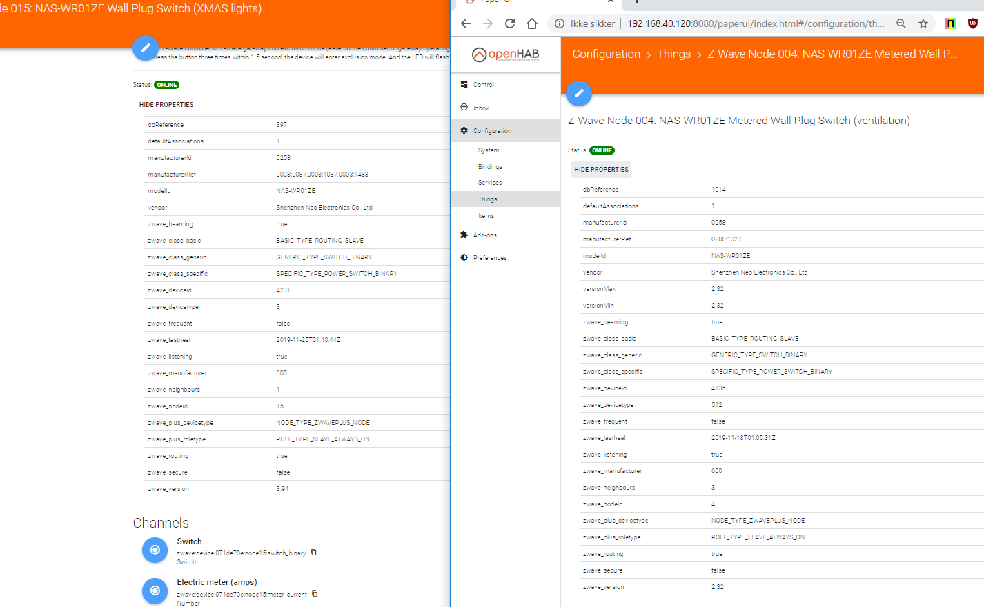

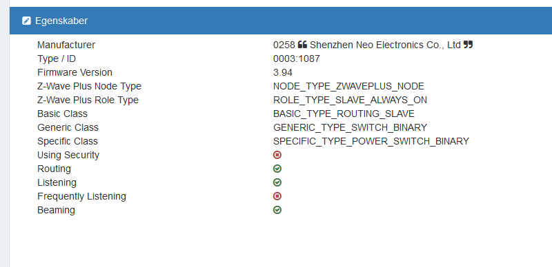

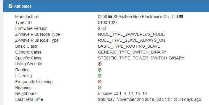

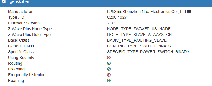

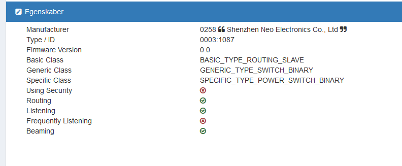

Not sure what the implications are but I tried removing and re-adding all the 2.32 ones and that seems to have solved the problem for all but one of them, which is detected as an unknown device.
Still got the one ghost device I can’t get rid of, any new solutions come to mind?
