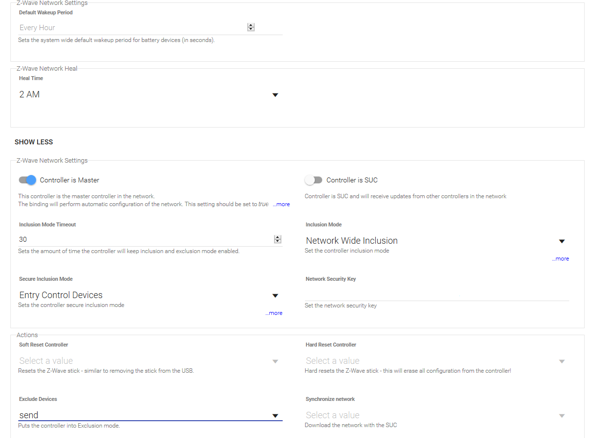

Could there be any wrong settings in serial controller? see below my setting

Is the setting correct of the usb-stick, can you please check, as i’m not sure if all is set as it should.

There aren’t really any settings in the controller - what you had looks fine.
