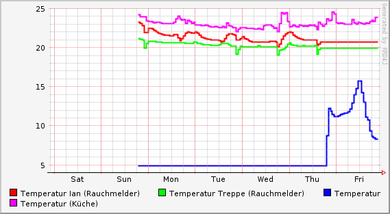

The red and green line show the temperature of the Z-Wave Smoke Detectors. You see, updates stopped working on Wednesday, then suddenly started to be updated again and since Thursday afternoon they are “stuck”.
(Pink and blue are MQTT sensors and they work fine (blue was switched off till Thursday).

I suspect that this is caused by the changes to ESH. I would suggest that you update to the latest runtime and it might start working again…
Basically ESH removed a method a few days ago, and the binding was updated to reflect this, but it means the binding is not backward compatible - it needs to be run with the latest OH runtime.
Are bindingsupdated automatically, if I use the online distribution of openhab?
I was not logged in to my server at this time, but I may have installed a Binding (Astro) via PaperUI. (I’m not sure about the time and even about the day …)
No - not as far as I know.
Mmhm, so then how the binding was updated?
I configured the Zwave binding in services/addons.cfg - maybe these binding are automatically updated?
binding = zwave, mqtt, yamahareceiver,caldav-command
However - I updated OH2 to latest snapshot release and now Zwave items work fine again. (I have several new problems, but all unrelated to Zwave… :stuck_out_tongue_closed_eyes:)
I don’t know, but clearly it was somehow… At least it’s working again.
