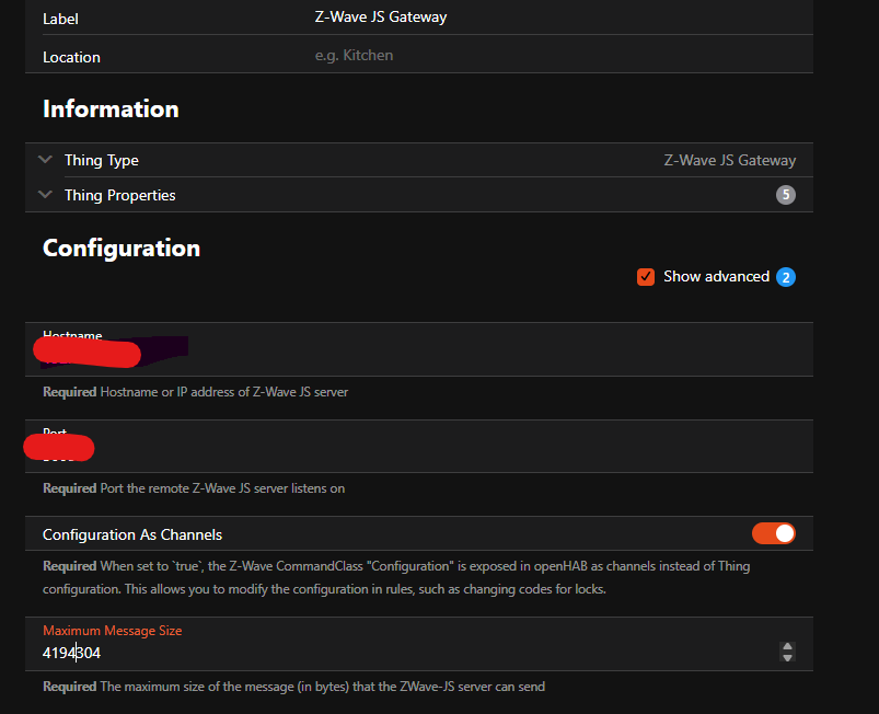

Hey had the same issue. Go into your Zwave JS gateway thing and click on advanced and increase the Maximum Message Size. Zwave JS sends all the zwave data in one giant message sometimes it exceeds as you add more devices.. i have 50+ items now and the below value is plenty.
That looks easy. I was trying to fix it from zwave js ui and from the docker container. ChatGPT and Grok failed me….
Thanks, I will give it a try.
