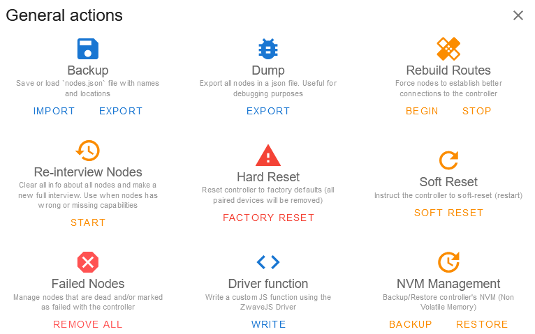

I have also switched to Z-Wave JS UI because I have all the tools for e.g. backing up the controller, deleting dead nodes etc. in one tool.

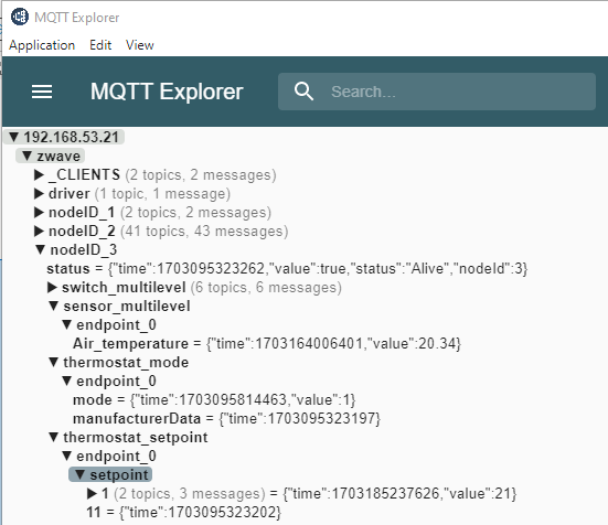

Now comes the part that is a little more complex. Extracting the correct information from the MQTT data and assigning it to the old items. I used the MQTT Explorer to do this.

First the information as I see it in the MQTT Explorer
To display the current temperature, I have to search for the Air_temerature entry and enter it in the corresponding channel in the thing.

- id: sensor_temperature
channelTypeUID: mqtt:number
label: Current temperature
description: Indicates the current temperature
configuration:
stateTopic: zwave/nodeID_3/sensor_multilevel/endpoint_0/Air_temperature
transformationPattern: JSONPATH:$.value
unit: °C

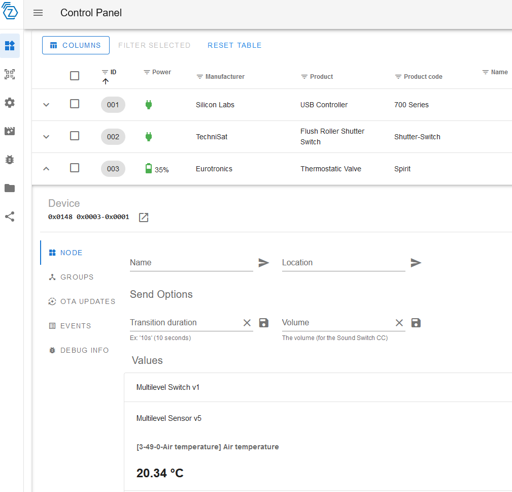

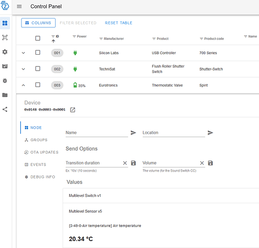

If I don’t know exactly where to find the current temperature value, I can also view this very nicely under Z-Wave JS UI
