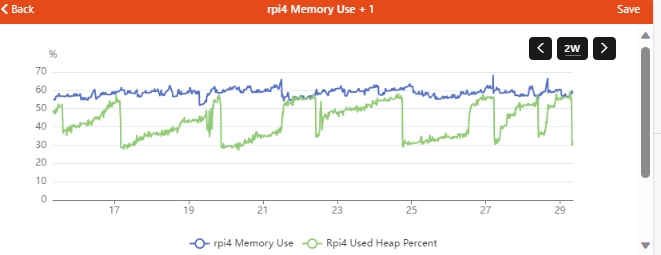

I installed ZUI in a Docker container on my Rpi3 and Rpi4 2GB devices with the bare metal openhabian (Yes, I know what that means!) running OH4. The Rpi3 only used the OHZ binding with 25 nodes and the Rpi4 2 GB had 34 Zwave nodes plus the IP camera, Remote OH, Mail, Network, MQTT, FTP bindings, plus all the rules for both devices. It was also running the MQTT broker and MysqlDB server. After transition, I observed about a 5-10% increase in memory use from about 55% and about 0.5% increase in CPU, but still below 1%. Below is a chart of the Rpi4 memory after transition.
The post transaction Rpi3 memory was running a little high for my liking, so after a week I made some changes. I flashed a new SD card with Debian Bookworm, added Docker and ZUI and used MQTT instead of the Remote OH binding to transfer all the Zwave measurements to the Rpi4. In this configuration I was using about 30% of the Rpi3 memory.
I did briefly spin up an empty new OH container (to see the current first time wizard) and the memory was running around 80%. Therefore, I think ZUI on top of OH4 (at least the way I did it with Docker) requires at least 2GB memory to be comfortable.

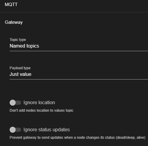

  • Configure the ZUI gateway to just send values and just send the node number. Do NOT use the Home Assistant discovery options. These setting reduce the transformations required to a few simple MAP files. It also means you can name the devices in the ZUI application without changing the OH transformations

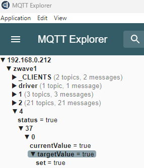

  • Create duplicate channels to each existing item using generic MQTT things, leveraging MQTT Explorer to copy the relevant topics. This doesn’t have to be done all at once or even while ZUI is running. You can stop ZUI, restart the Zwave binding and link the topics at your leisure, although stale data during a long transition will be an issue.

      * UPDATED: Generic Mqtt examples for UI "code" tab (now using Named topics, Just value & Ignore location in ZUI gateway)

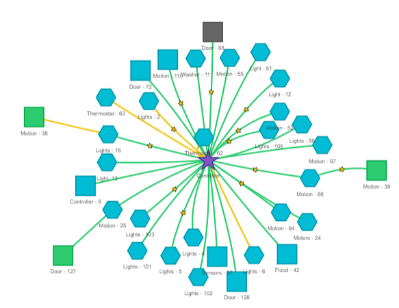

Not sure what you mean? As noted above, I wasn’t having a particular performance problem with OH ZWave. However, I was using my unmerged 700 controller PR, so it was a 700 to 700 comparison. I did get improved routing with the 700 controller. Most nodes are in direct communication with the controller at 100KB. I like the network tab on zwave-js-ui as it shows actual routings, not just neighbors.
I found Snap to be problematic on Debian Rpi OS in finding the controller, so settled on Docker instead.
This is what I was hoping to see, not so much speed which I don’t expect. The few (battery operated) devices I have connected on the Zstick7 are as far from the controller as can be, and they work fine.
I did get better range with the 700 series. The nodes above that are two hops (green) are actually outside the house. Thanks for trying this and post any observations you think may help others.

Also I noticed I did not suggest using MQTT Explorer. Do you have that installed? Here is a switch that I turned on in OH
I’ve been using MQTT and explorer for a while with connections to home assistant. Must be one of my settings. I tried the /set topic and didn’t have a positive result. Thought maybe I may have missed a minor detail, but apparently not. I’ll keep at it.
Assuming you can see the /set message work in Explorer using zwave-js-ui (and the current state reflected in OH, but not changed in Explorer with the OH switch, maybe putting OH-Mqtt binding in debug might show why the message is not published?
