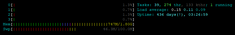

On my systems the Rpi4 average 1-5% CPU and the programs (Docker, OH5.0M2 and ZUI) use .75 out of 1.8 GB. On the Rpi5 CPU runs between 1-10% (when the IP camera binding is recording). The programs (Docker, OH5.0M2, ZUI, MQTT and MySQL) use 1.7 GB out of 3.95.  Unrelated to your questions, I did have to figure out Samba without the aid of openHABian and I used a RPi clone application to transfer the SD card contents to SSD’s.
