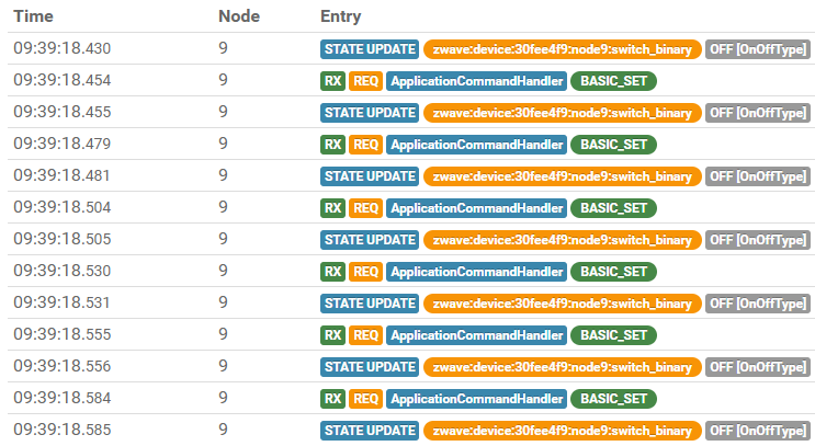

Zwave log flooded with always the same basic set and state update
I am using OH 2.1 with zwave nightly 20th. sept. Short after paring the Node 9 (Steinel motion sensor, luminance and light switch), the log is flooded by always the same entries. The device functions are working ok. This happens also after restart of OH. OH is newly set up with just 3 other nodes (roller shutter) which work fine.
Logfile

From a quick look, these messages seem to be sent unsolicited from the device. Since you have debug logging enabled, you are seeing all these messages.
ok- this means, the device is sending without unneeded data? Could this be a bug? I was fearing that this will overload my zwave network..
I don’t know why the device would send this - I don’t know what the device is, or how it’s configured. Try resetting it to see if that fixes it?
I already resetted a few times. After some hours this unsolicited data always appeared.
Then maybe I should contact the manufacturer for a fix?
I’ve run this through the log viewer to make it easier to read -:
I would suggest to check the configuration to make sure you’ve not set something incorrectly, otherwise, yes, speak to the manufacturer.
I checked config. Could it be related to the fact that I only using the association “lifeline” and not all the other like “motion” and “luminance”. Device (xledhome2) has more than one association group.
Maybe I made a mistake when entering the device data in the zwave database (xledhome2), as I am novice I am not sure.
Thank you for your help!
Normally, you should only need the lifeline - although it depends on the device implementation. However, if you have mre than one association group set to the controller, then you will end up with multiple messages, but just a small number each time the status changes.
I make the assumption that the log above continues - ie we see 6 BASIC_SET messages over a 150ms period. Does this now stop until the device status changes, or does it continue? I assume it continues as you talk about flooding the log. If it only happens every X minutes when the device status changes, then I would likely have a different answer, so please can you confirm this.

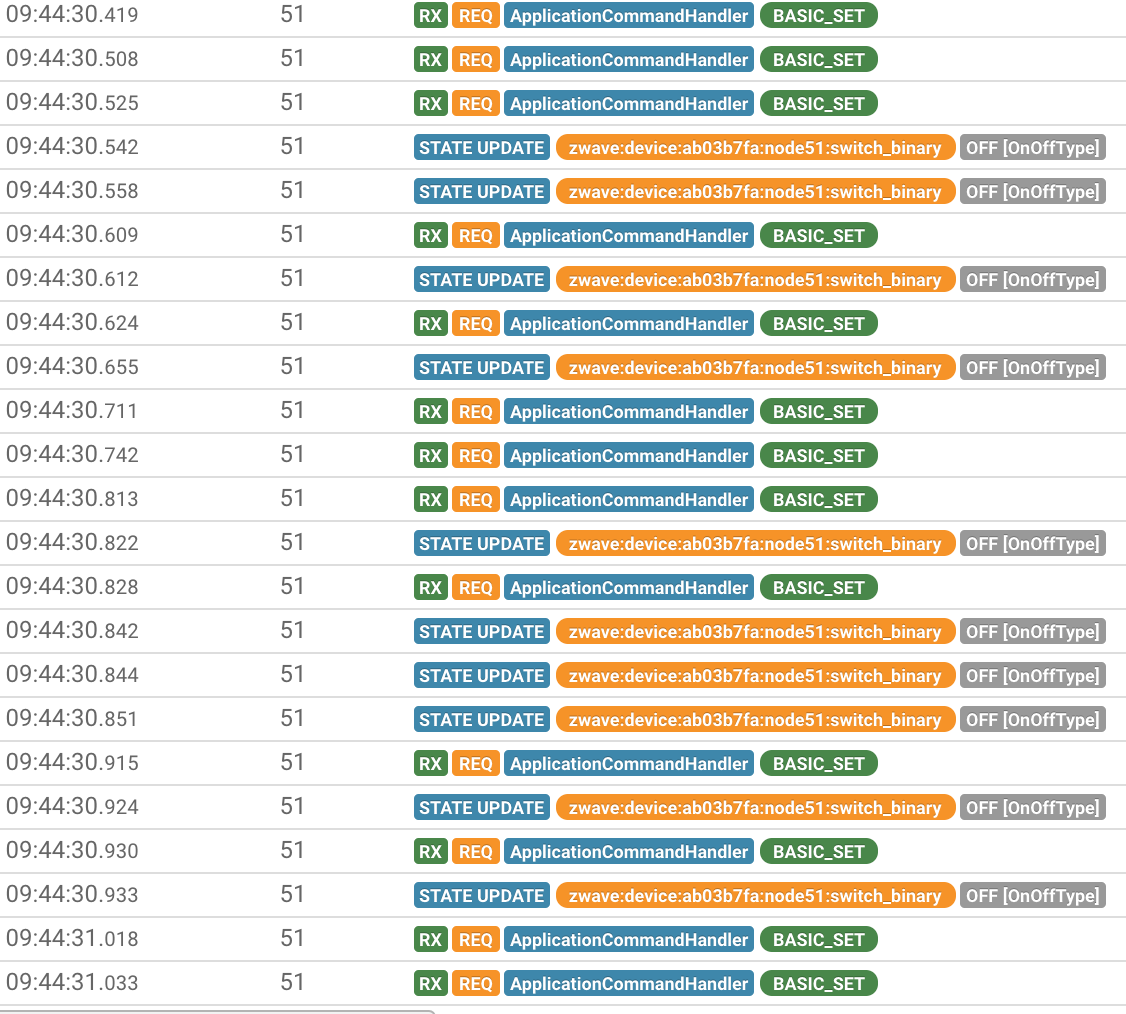

Today I tried again with a “fresh” node (I excluded the device, than included).
Then initialisation started (latest nightly zwave binding with OH 2.1 stable), after some seconds then the chatter started.
It stopped, when I did this two things: generating a motion by waving my hand in front of the motion sensor and after this moving the including button on the device to send a nif.
Having done this, initialisation suddely was finalized and the device is reporting fine.
I am fearing that after restart the chatter will start all over.
What do you thing, could I give you some clues?
As expected after one night this morning the “flood” started all over again, I didn’t change anything.
I was not able to use any device since the network was overloaded because of this node51.
Just for the discussion with the vendor: is the device faulty or is openhab the cause of this problem?
Log file is attached below (I am not allowed to attach a file)

From what we saw earlier, OH doesn’t send anything to the device. It looks like that is also the case here, although this is a filtered log, so I can’t be 100% sure. If OH doesn’t send anything, then I don’t think we can blame OH.
Ok. That’s what I expected.
I could provide an non- filtered log but don’t know how since I am not allowed to upload log files.
Could I send it via email or so?
Thank you.
If you like to create a ticket on my website (www.cd-jackson.com) then you can upload files up to 10MB I think. You will need to register to see the option to open a ticket, but it’s a bit easier for me than email as it keeps the thread together…
I created Ticket ID: m2hVjYWTcxQ and uploaded the log file
So as expected, there is nothing coming from the binding - only lots of messages coming from the device. I really think that the device has a problem.
Below is just a short part of the log, but it goes on (as you know already :wink: ).
I tried different configurations and could reproduce the “flooding”.
It always happens, when I add the controller node to association group 2 (control key). When removing controller from this group, flooding stops.
Furthermore OH seems to add the controller node automatically to all groups, when you restart openhab bevore it could finalize initialisation and write the node.xml.
I will observe the log files the next days (and reboots) if my theory is right.
Why did you add the comment in the database? There should not be a problem adding the controller to an association group - if the device is sending a message every few milliseconds, this is (IMO) a problem with the device as stated earlier.
Yes, I did to protect other users having this this problem until the manufacturer fixes it. I don’t know any other way to “warn them”, sorry.
The challenge is, that the technical support (of the manufacturer Steinel) told me that their devices do work fine with their own smart home box and they are not able (sounded to me more like “don’t want”) to provide help at the moment for another smart home software like OH. They also told me that they already received other complaints for their z-wave devices not correctly working with OH.
Are you sure it is not just a problem with your device - ie it’s really a problem with the design? Do you know it works ok with “3rd party devices”?
I’m happy to work with them, but I don’t see that the binding is sending anything to the device so it’s really hard for me to understand how OH can cause this. In my opinion, in NO circumstances should the device send lots of messages at this rate. To me this can only be a problem with the device, but I know it’s easy for people to blame others :wink: .
Well, the problem seems indeed to be related to the device itself (I have two of them).
The “flooding” starts when any software puts the the controller node in the devices association Group 2 – “On/Off control”. This then seems to be stored in the device itself. Also my open-zwave (hass) and another software which shows zwave raw data get those messages when the controller has been added to group 2.
That’s why I think you are absolutely right that the device (software) is faulty. But from my point of view any smart home software including OH will get those message flood when the add the controller into Group 2 of the device.
How can I help making contact between you and the manufacturer? As I wrote they are very eager promoting their own eco system and don’t seem to have much experience in zwave.
Attached the link to their z-wave page (german): http://www.steinel.de/de/smarthome/smart-friends-smarte-bewegungsmelder-leuchten-strahler
