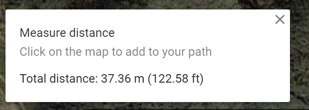

The last hop is the long one and my zniffer was by a window at the closest point.
From google maps

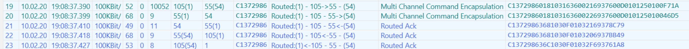

Fibaro switch with the wire antena nice and straight pointing vertical. RSI surprisingly high but node 55 is a bit further inside the house.
RF is weird. 100KBit
Just to let you know the full picture.
Controller UZB3 latest firmware.
105 fibaro smart implant
54 fibaro switch 2
55 fibaro switch 2
